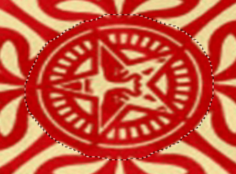

When making a selection, sometimes you grab areas you don’t want. When this happens, instead of redoing your selection, use Remove icon from the Selection tools in the Windows 10 version of Autodesk SketchBook Remove. This way, all you need to select are the areas you don’t want to remove them from the selection.
Removing sections from a selection in Autodesk SketchBook Removing sections 2 from a selection in Autodesk SketchBook
Removing sections from a selection in SketchBook Pro Desktop
  1. Once you’ve made a selection, tap Remove icon from the Selection tools in the Windows 10 version of Autodesk SketchBook, then either tap-drag to remove sections from it or for the Magic Wand selection, tap areas you want deselected.

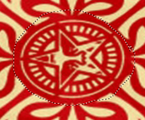

Removing sections from a selection in SketchBook Pro Windows 10
When making a selection, sometimes you grab areas you don’t want. When this happens, instead of redoing your selection, use Remove icon Remove. This way, all you need to select are the areas you don’t want and they are removed from the selection.
Note:
If you just want to delete your selection, use the Cut tool in the Layer Editor.
  1. Once you’ve made a selection, tap Remove icon from the Selection tools in the Windows 10 version of Autodesk SketchBook, then either tap-drag to remove sections from it or for Magic Wand selection, tap areas you want deselected.
