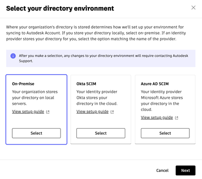

  2. Click on the Set up directory sync button and select on-premises as your directory environment. Click Next.

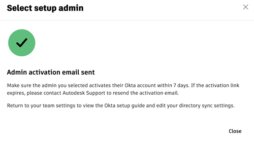

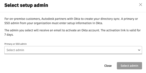

  3. Next you will need to select a primary or SSO admin from your team who will set up the directory sync connection in Okta.
  4. Use the dropdown menu to choose an admin and click the Select Admin button. This admin will receive an email to activate an Okta account. The activation link is valid for 7 days.
