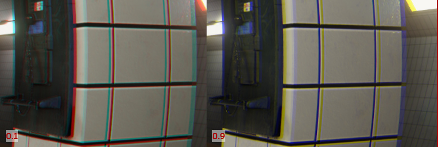

Fringe Color
Shifts the colors of the chromatic aberration fringe, which simulates the inability of the lens to focus all colors of light with the same precision. This causes a vertical band of color to appear at the edges of objects.
Values closer to 0 make the fringes cyan and red. Values closer to 1 make the fringes purple and yellow.
Fringe Intensity
Controls how wide the chromatic fringes are.

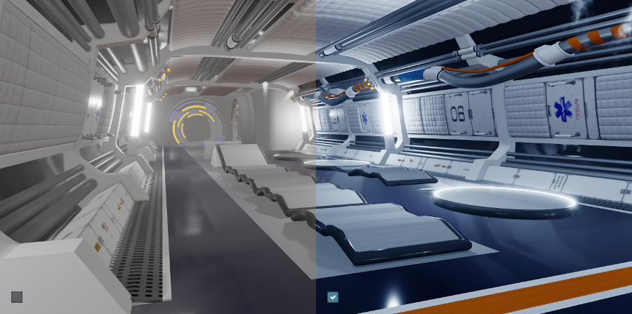

Color Grading
Color grading changes the color space of the rendered images produced by the Stingray renderer. The effect is to adjust things like the colors, hue, saturation, and brightness of the game, based on a volume map texture that you provide.
For example, the following image boosts the contrast and shifts the colors toward blue.
See also How to apply color grading to a level.
Enabled
Turns the color adjustment on and off.
Color Grading Volume Map
Specifies a volume texture resource that defines the desired output color space.
The default texture, core/stingray_renderer/environments/color_grading_identity, causes output colors to be rendered as-is after color grading. You can adjust this default image in image processing software like Photoshop, import the modified image into your project as a new texture, and set this value to point to your new texture.
The texture has some specific format requirements. It should be saved as a volume map in 8.8.8.8 ARGB format, without mip maps. In addition, you must open the texture resource in the Stingray Texture Manager and disable any processing during compilation. See the tutorial under How to apply color grading to a level.
