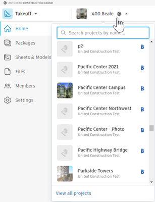

Create or Select a Project
You can select an existing project or create a new project to use in Takeoff. Access all options for creating or selecting a project from the project picker drop-down at the top left of the page.
Select a Project
If Autodesk Takeoff is enabled for your project, select that project in the project picker drop-down at the top left to open the project and use it for takeoff.
You can also select and open projects from the Project List. To go to the Project List, click View all projects at the bottom of the project picker list.
