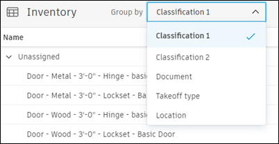

Group Inventory Items
You can change the view of your inventory by grouping items in the table by Classification 1, Classification 2, Document, Takeoff Type, or Location.

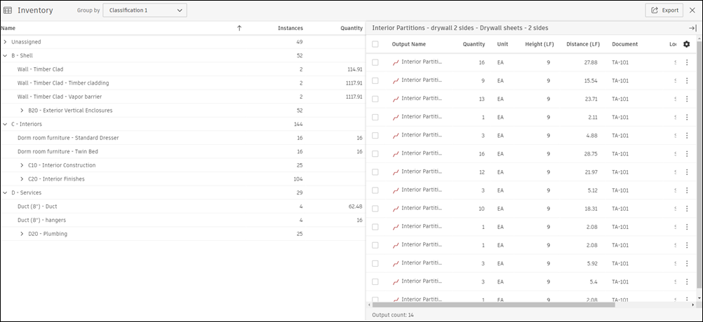

Inventory Details
Clicking a line item in the inventory opens information about the takeoff items and outputs for the takeoff. This information appears in a details panel to the right of the Inventory panel. This view is open by default, but can be minimized. In the panel, you can:
  • View quantity details of selected outputs
  • Fit to view to show selected takeoff in sheet or model
  • Reassign an object to a different takeoff type
  • Delete takeoff

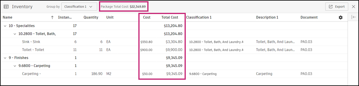

Cost in the Inventory
The Package Total Cost, if one is available, is shown at the top of the Inventory panel.
If you have assigned a cost for any takeoff outputs in your package, the unit Cost of these outputs and Total Cost of all quantities of that output will be shown as columns in the inventory.
Note:
Total Cost in the inventory is calculated by multiplying Cost x Quantity of a given takeoff output.
