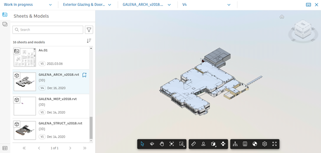

In the Takeoff viewer, use the Sheets & Models panel to locate, view, and perform takeoff on sheets and models.
The Sheets & Models panel shows the list of all uploaded and published sheets and models that can be used for takeoff. Click a sheet or model in the panel to open it in the Takeoff viewer.

Panel Tools in Sheets & Models
The following Sheets & Models panel tools can help you locate the files you want to use for takeoff in a given takeoff package:

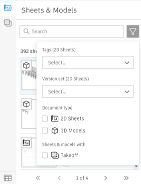

- Filters – Locate sheets and models for takeoff by filtering by tag, version set (for 2D sheets), document type, or files with takeoffs.
- Search – Search the list of sheets and models by name or title.
- Sort – Sort the list by name or title or date modified.
- Bookmark – Bookmark a file within a takeoff package by clicking the bookmark icon in the panel list. Bookmarking moves the file toward the top of the list for that takeoff package.

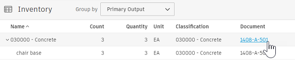

Locate Sheets & Models with Takeoff Items
You can easily locate sheets and models that have existing takeoff items in a takeoff package by using filters and reviewing the inventory.
Use Filters - Filter files by ‘Sheets & Models with Takeoff’ in the Sheets & Models panel.
Review the Inventory - Look in a takeoff package’s Inventory. Under the Document column, find a list of files with takeoff items, along with links to the files.
