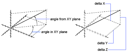

You can retrieve information about the relation between two specified points: for example, the distance between them or their angle in the XY plane.
To determine the relation between two points, you can display the
  • Distance between them
  • Angle between the points in the XY plane
  • Angle of the points from the XY plane
  • Delta, or changed, X, Y, and Z distances between them
