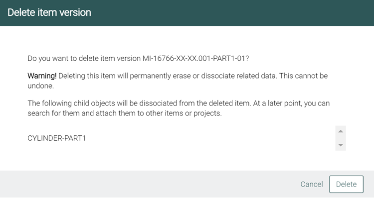

Delete an item version
  1. Locate the item version you want to delete.
  2. Click the more actions icon (moreactions) next to the item and select Admin > Delete.
    Upchain shows a warning message indicating that you are about to delete the item and its associated files.
    bm-delete-item
  3. Click Delete.
    Note: You may click Cancel if you do not want to delete the item version.
The selected item version and its associated CAD files, drawings, translations, and supporting documents are deleted from the tenant. An email is sent to the item creator that the item version was deleted.
