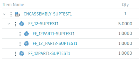

You can export a flat list of all parts included within an item's eBOM to an Excel spreadsheet. Each row contains one part where the quantity is tallied across the entire eBOM, taking into account its immediate parents' quantities.
For example, in the following BOM, the quantity calculated for the FF_12PART1-SUPTEST1 part in the Excel spreadsheet would be (5 x 1) + 1 = 6.
export quantity
