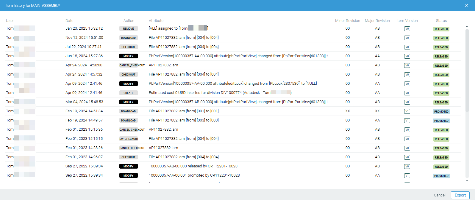

Click Expand expand to open the history details in a new window. When expanded, the history includes the history from any previous item versions that have the same item number, including Promoted item versions. This window shows a maximum of 200 entries. Click Export to export the full history of the item to a CSV file.
expanded history

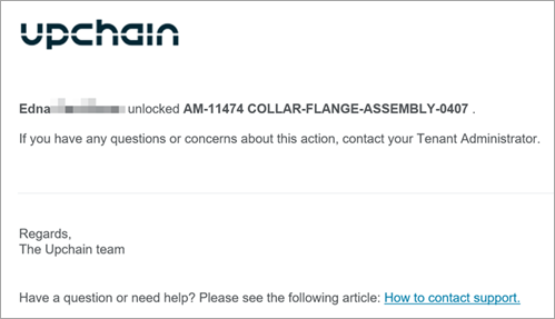

When a Tenant Administrator clears a lock from an item, the lock’s creator receives an email notification indicating the lock has been removed.
email notification about locks cleared by the Tenant Administrator

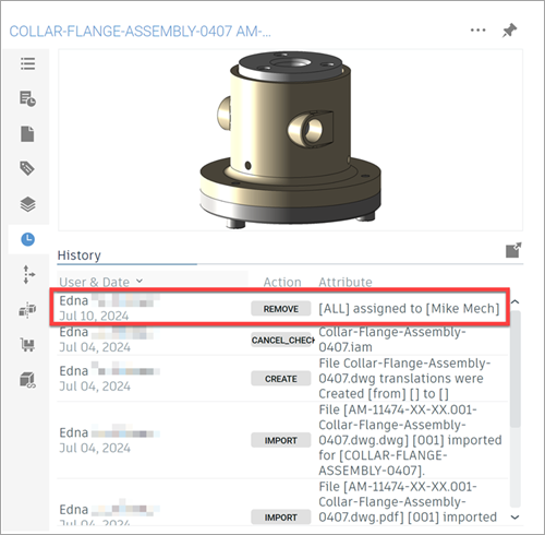

A record of the lock removal is recorded in the item details pane > History item history tab.
history in item's details pane
