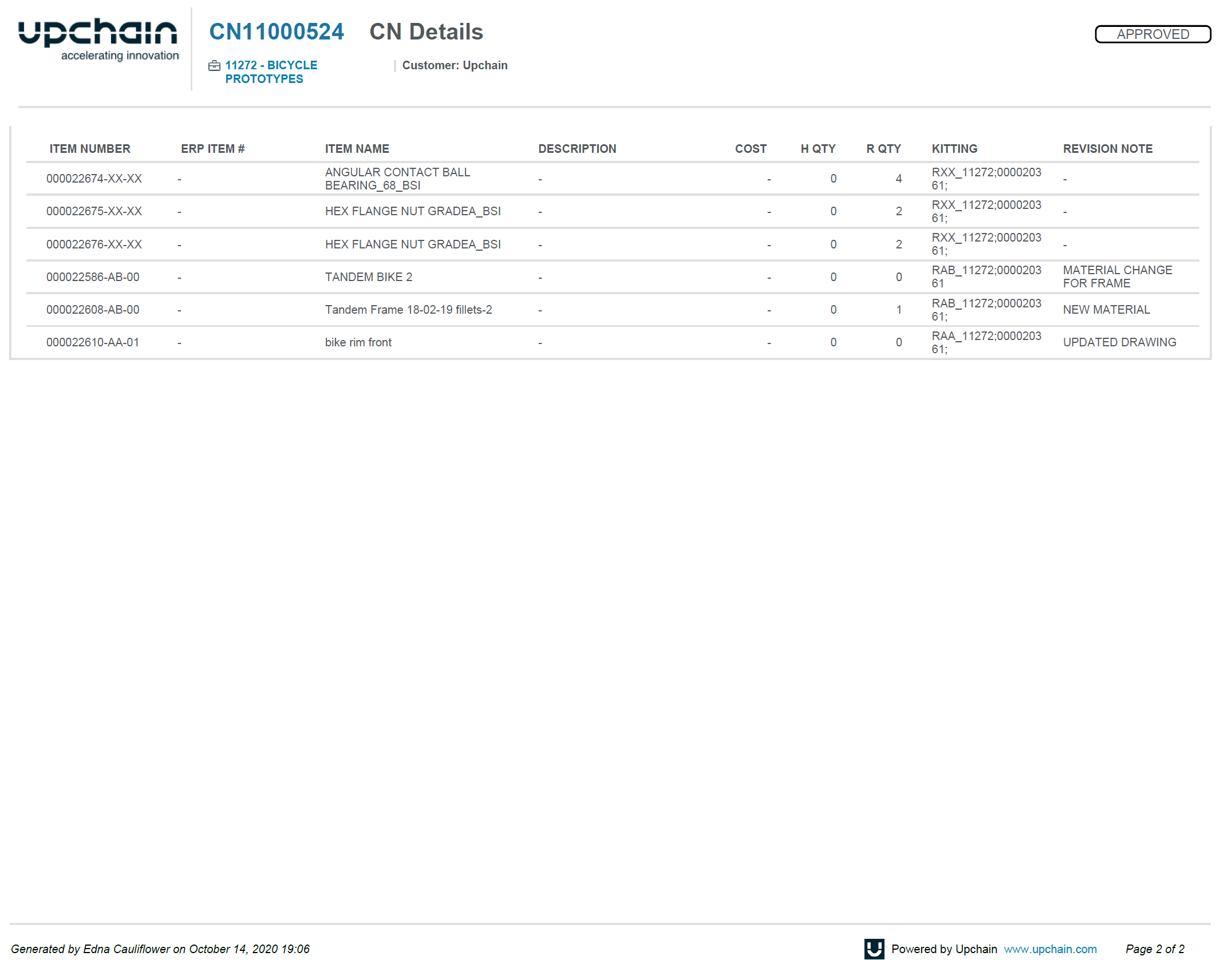

Generate a Change Notice Details report
The default CN Details report includes the following information:
- Item number
- ERP number - Item's number as stored in the ERP system
- Item name
- Description
- Cost
- H (historical) quantity - Quantity recorded in previous CN request
- R (requisition) quantity - The new, modified quantity recorded in the CN request
- Revision note
Follow these steps to generate the Change Notification (CN) Details report.
Locate the CN for which you want to generate a details report.
Double-click the CN to open the CN for which you want to generate a report.
Click the more actions
icon and select Reports > CN Details. If your organization has any custom CN reports, these will be listed here as well.Upchain notifies you that the report creation is in progress.
You will receive an email when the
<Project#-CN_Details-YYYYMMDD-HHMM>.xlsxreport is ready.In the email, click Download to save the report to your computer and view the report.
