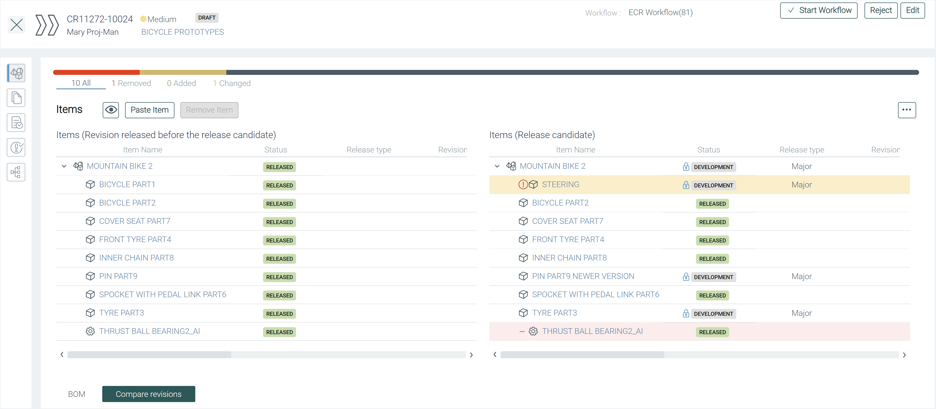

Compare eBOM changes
You may compare the difference between the current release candidate's eBOM and the eBOM of its previous released version. This functionality is located at the bottom left corner of the Items tab under Compare revisions. This view is for information purposes only and looks something like this:
The left side displays the previous released version of the release candidate item on the current change request (CR). The right side displays the current release candidate on the CR. This is made clear in the column headings.
Changes showed under BOM Compare are as follows:
  • Item removed - Highlighted red with a (-) sign.
  • Item added - Highlighted green with a (+) sign.
  • Quantity, Material, and Revision changed - All three of these changes are highlighted yellow with an attention (!) icon. Hover your cursor over the icon to reveal more info about the change.
