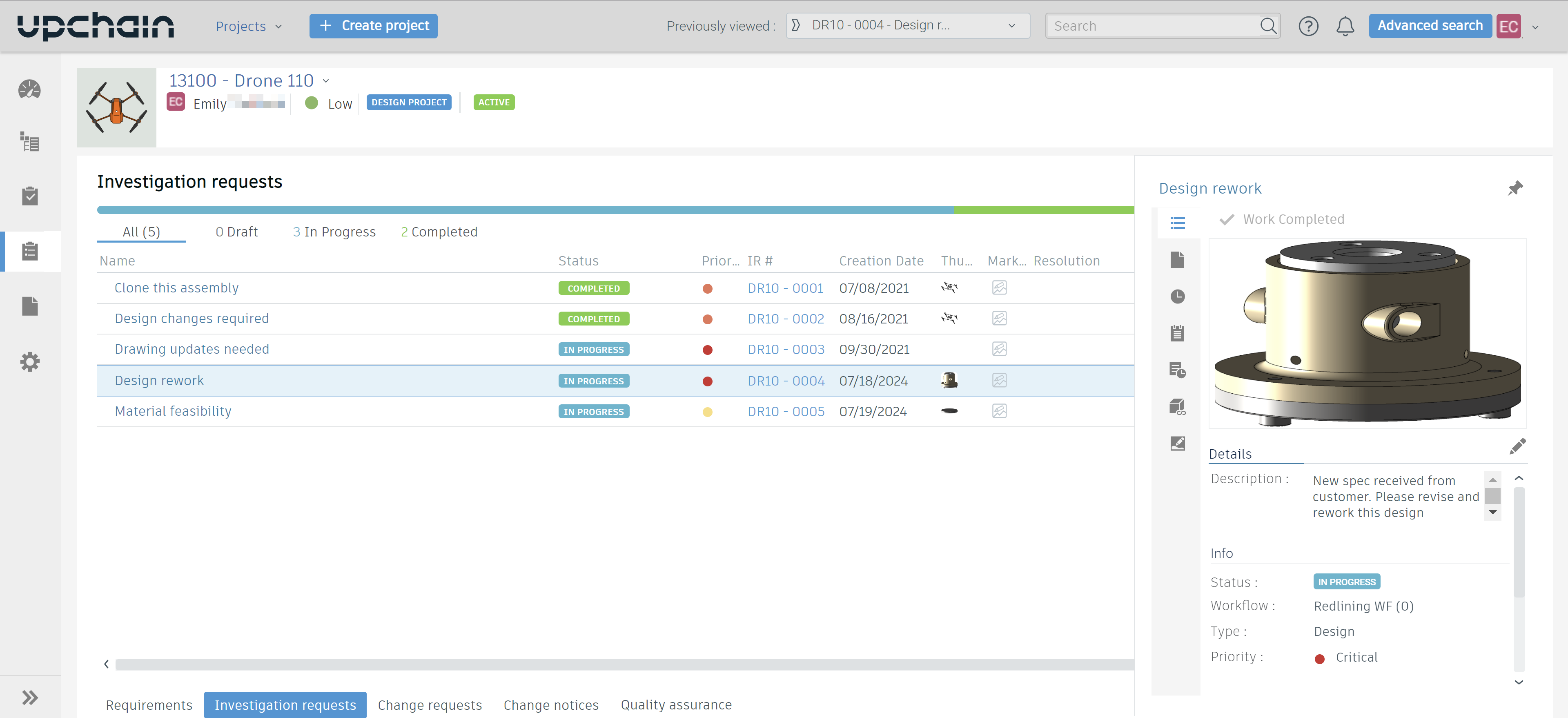

The investigation requests (IR) interface shows a list of all IRs in a project.
invesigation request dashboard
Note: This image shows Upchain's new theme. Click the chevron next to your profile icon in the main dashboard to open the user menu and select Switch theme.
  • Click the status filters along the top to filter IRs by status.
  • Right-click any column heading and select Group by to group IRs by the chosen column value.
  • Click Add IR in the top-right corner to create a new IR.
  • Click the tabs in the bottom of the interface to navigate to the Requirements, Change requests, Change notices, or Quality assurance interfaces.

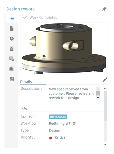

Select an IR in the list view to open its detail view, which shows additional information associated with the IR and may contain buttons located near the top of the detail view to move the IR along its workflow.
ir detail view
Tip: To keep the detail view open while you browse the list view, click the pin icon (pin icon).
Details tab
The Details (ir details tab) tab shows an IR's details including its description, status, workflow, type, priority, creator, assignee, and creation date. Click Edit (edit ir details) to update these details, then click Save (ir details save).
