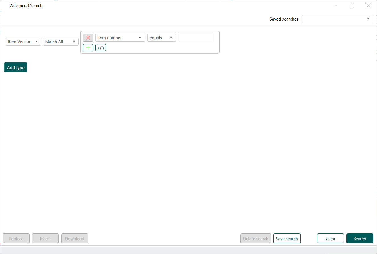

The Advanced search window opens.
Select an object type - the type determines what the output format is and what attributes you can select to search for this object type.
Select Item Version for a list of items.
Select File for a list of CAD files and their translations (ie. all other Documents you find in Document categories on the items and projects are not included).
Select Project for a list of projects.
Select Customer for a list of customers.
Select eBOM for a list of items that match the eBOM attributes selected.
Tip: Select Item Version or File to return a list of items or files, which you can then download from the search results. Add Project, Customer, and eBOM attributes to help you specify additional attributes to narrow down your search. Read on to learn how.

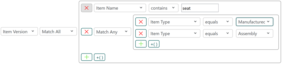

Add additional lines to search using more than one attribute.
Use the
or
icons to add or remove additional lines to add more attributes.Click
to add a sub-collection of search criteria that falls within the same object type. This sub-collection is also governed by its own search type operator (Match All, Match Any).Note: These functions add additional attributes for the same object type.

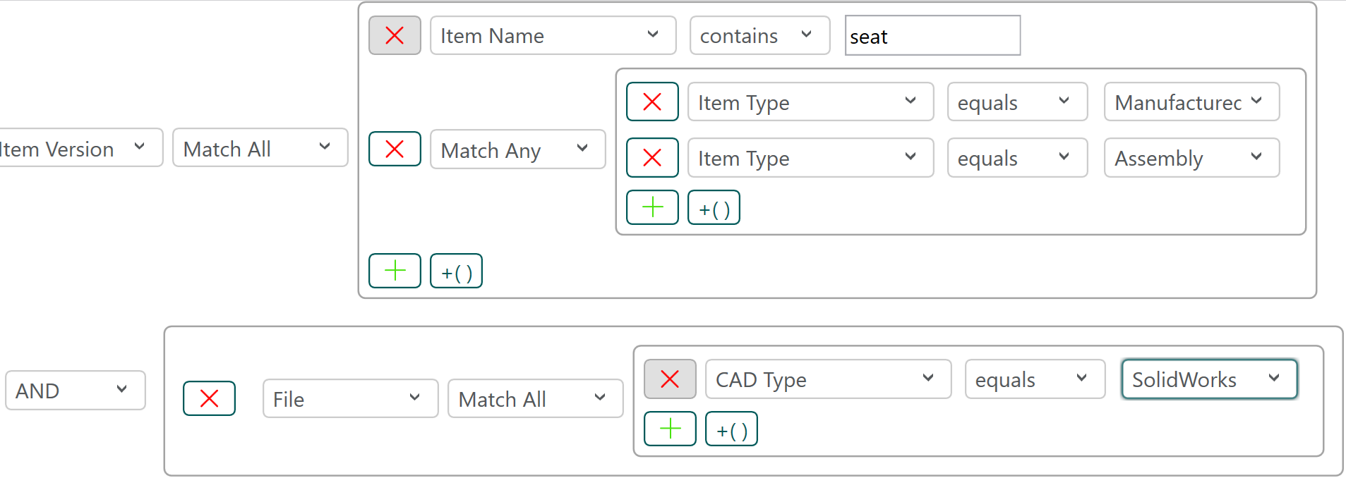

Click Add type to add an additional object type to search by to further narrow down your search.
Use the AND operator to search for objects that match both types.
Use the OR operator to search for object that match either of the types.

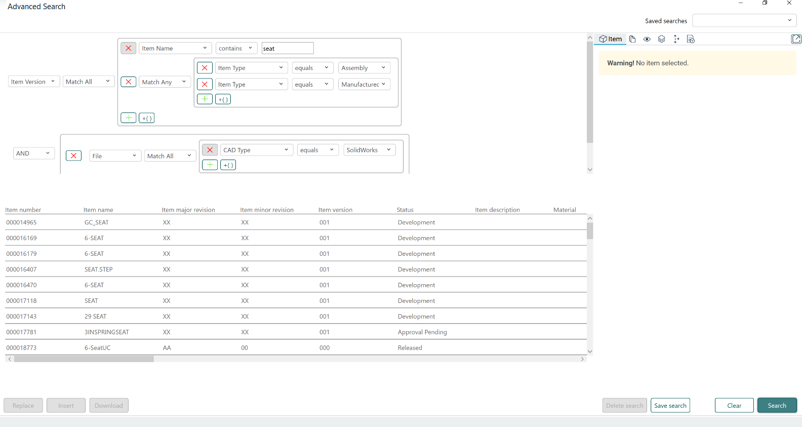

Click Search.

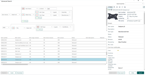

Your search results are displayed in a table. The objects shown depend on the object type at the top of your search criteria. In the above example, the search results are items where both the item name contains the word 'seat' AND the item type is either a Manufactured item type or Assembly item type, AND also contain a SolidWorks file.
Review the search results
The Advanced Search window allows you to view the details of each result in the item detail view on the right side of the window. As you click each item in the search results list, the item detail view is displayed on the right side. This allows you to preview each item before deciding which item you'd like to work with.
