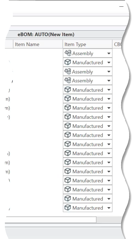

The CAD Check in window. It includes an Item Type column on the right side (eBOM).
By default, Inventor items are assigned according to their defined type in the Inventor BOM table. For all other CAD items, a new assembly is assigned as Assembly and a part as Manufactured Item.
If you import items as phantom, no item type is assigned. You can check out the item separately to assign a type to it.
For each entry in the Item Type column, select an appropriate item type from the drop-down list.
The drop-down list is populated with all pre-defined item types in the current tenant.
Click OK.
