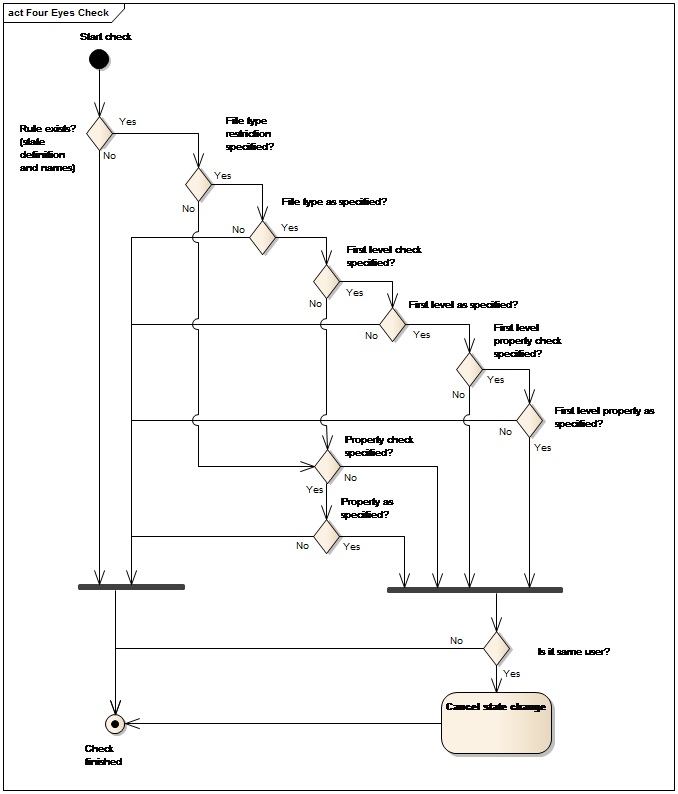

Four Eyes Check
This functionality is used for supporting security measures (another user than originator must check / approve).
The check is applied during a state change on a document. It contains a control whether the current user is the same user who has executed the previous state change. It contains two parts: Pre-check and User Check.
Precheck
  • The state change must be defined (lifecycle name including from state and to state)
  • The pre-check contains several conditions at two different levels
  • Level of the selected document (File extension and Property condition)
  • Level of the related documents (File extension and Property condition).
    Note: Only first-level documents are considered.
  • Please have a look at the flow chart to determine the circumstances which have to be met by the Pre Check in order to be successful.
User Check
  • After a successful Pre Check the User Check will be done.
  • Current User will be compared with the previous User
  • Previous User: the user who has changed the previous state to the current state
  • The state change will be canceled when Current User and Previous User are equal. In other words: The two users must be different.
If the Precheck was not successful, the user check won´t be executed, and therefore the state change won´t be canceled under any circumstances.
