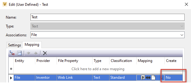

There are mappings between Vault properties and the file properties. Copy Design attempts to synchronize properties but the action fails if the property does not exist on the files in Vault (Vault property mappings are set to Create = "No").
To resolve the property update failure warning:
- Use templates that have all the required file properties to create files.
- Set the property mappings to Create = "Yes" for the required properties.
