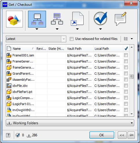

  • Full GUI
    An interactive GUI appears that allows users to modify the options (gathering options, which files to check out, comments, download location, etc.). This GUI allows files to be viewed in a List View, Folder View, or Design View. All of the views support configurable columns which include support for thumbnails.

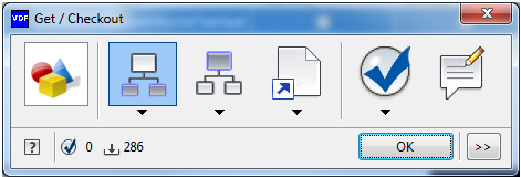

    The Download/Check out dialog has a collapsed and expanded display.
    Collapsed
    Expanded

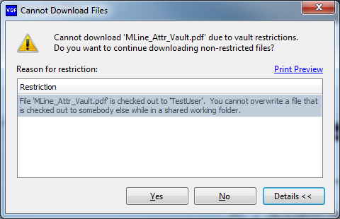

Restrictions
The VDF detects if any of the following conditions exist prior to attempting the download.
  • File is checked out to someone else.
  • File is checked out to the current user on a different machine.
  • File is checked out to the current user in a different directory.
  • File is locked and cannot be edited.
  • File is checked out to another user in the same shared directory.
If the condition does exist, there is a choice as to whether or not the operation should be canceled or continued by skipping files with the problem(s).
The logic that decides how to handle the problem is extensible, and a custom resolution engine can be supplied.

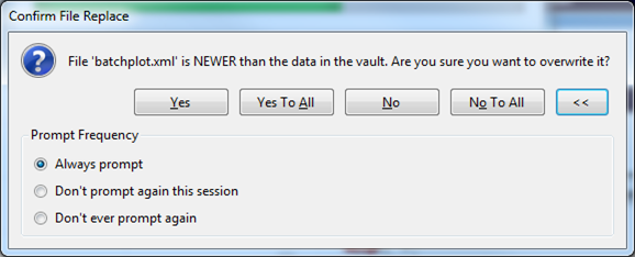

Local Disk Synchronization
The VDF checks if the file on disk is out of sync with the version of the file in the vault. In this scenario, there is a choice as to whether the file should be overwritten or if the download should be skipped. The resolution logic is extensible and the default handling can be replaced with a custom solution.
    The following scenarios are detected:
  • If the file on disk is the same version and has the same checksum as the file being downloaded, the download is skipped.
  • If the file on disk is already checked out to the current user in the same location.
  • If the file on disk is newer than the file being downloaded.
  • If the vault file does not exist on the remote server that the user logged into and it needs to be replicated.

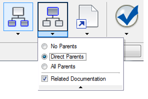

Relationship Gathering
When downloading or checking out a file, you can specify whether any related files are also downloaded or checked out. The VDF supports relationships for including child relationships, parent relationships, or files brought in through links.
  • Include Child Relationships
  • Include Parent Relationships
  • Include Linked Entities

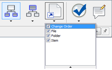

Multiple Entity Download
The VDF not only supports file and folder downloads, it also supports entities such as items, change orders, or custom objects. The VDF interrogates these entities and selects the primary files associated with them for download.
