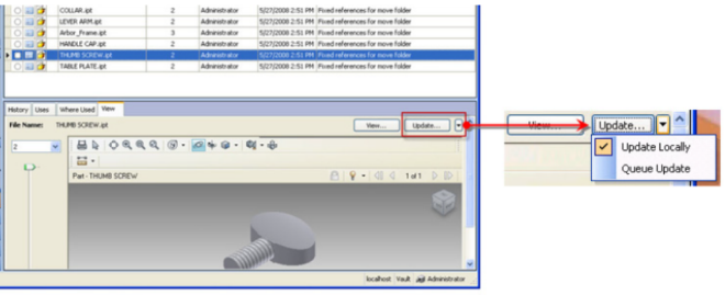

    Submit a Single Job Using the Vault Client
    Send a job to the Job Server for processing with the Vault client.
    1. Select a file and select the arrow next to the Update button.
    2. In the menu that appears, select Queue Update.
    3. Click the Update button.
    Note: This setting will remain constant and every time you select the Update button, the Job Server will be used to create the Visualization file.
