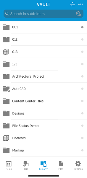

The TabBar displays all the workspaces for the user to navigate to - Items, COs, Explorer, Files, and Settings. Data is organized into tabs, for example, Properties, Bill of Materials, History, and Records. Switch between different workspaces and tabs to access, organize, and share your design data.
- Items - The Items tab lists the items in the Vault. Select an item to display its item details.
- COs - The COs tab lists change orders in your worklist by default. Select a change order to display its change order details.
- Explorer - The Explorer tab lists the files and folders in the Vault. Select a file to display its file details.
- Files - The Files tab provides insights on file activity in the Vault.
- Settings - The Settings tab displays information and options for configuring the Vault mobile app. You can control specific behaviors for thumbnail, activity, search, and visualization. For more information, see The Settings Tab.

The Search here only searches for objects specific to the environment that it is in. Select the Search Options icon
in the search bar to access other types of search, such as advanced searches. You can multi-select files in your search to move, delete, or select/deselect all files in bulk.
