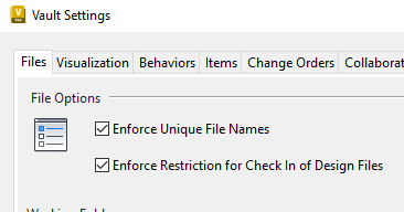

Vault Settings Options
Go to Tools > Administration > Vault Settings and set the following options:
- Enforcing Unique File Names
- Disable Check in of Design Files
Enforce Unique File Names
After bulk loading historical data to the Vault, turn on "Enforce Unique File Names".
By default, unique file names are not enforced in the Vault. The only restriction is that two files with the same name cannot exist in the same folder. With unique file names enforced, files in the Vault must each have a unique, identifying name. See Enforcing Unique File Names for more information.
Enforce Restriction for Check In of Design Files
The "Enforce Restriction for Check In of Design Files" option prevents users from uploading restricted files into the Vault. By default, this option is checked. See Manage File Restriction for more information.
