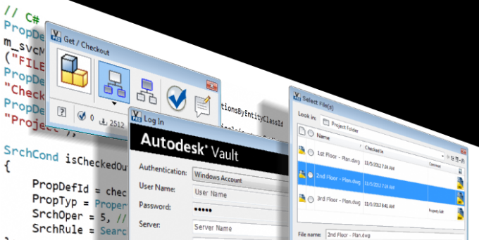

The Vault Developer Framework (vdf) is a high-level framework on top of the existing API.
The vdf provides:
- Reusable business logic for common vault algorithms
- Reusable GUI controls for common workflows
- Extensible components that can be configured to match host requirements
The vdf mission is to deliver extensible, light-weight data management components that allow new add-ins and client applications to be created quickly. In addition, the vdf enables existing add-ins to benefit from continued feature development and enhancements.
The diagram below shows how the vdf relates to the Vault Server and your client applications.
