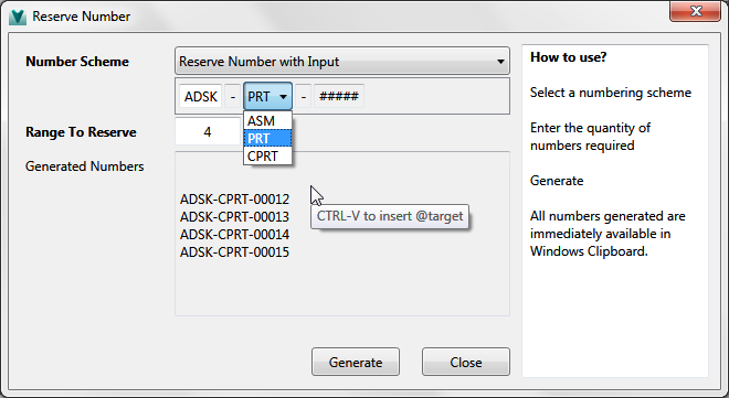

Recommended: Use Vault Data Standard to apply numbering schemes and enforce user input for certain properties. Administrators can configure Data Standard to reserve a number range for parts.
This is the best way to standardize the creation process and ensure that related parts are grouped by number.
Share Numbering Schemes for Items and Files
Optimize data management of related items and files by sharing numbering schemes. Use Data Standard to reserve number ranges.

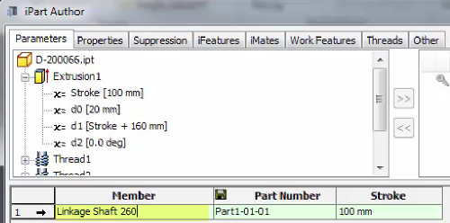

When creating a new iPart, perform these steps:
  1. Go to the Add Member table, copy the file name, and paste it into the Member field.

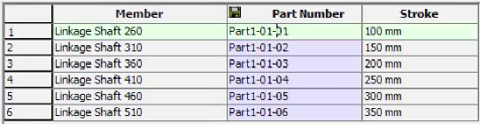

  2. Insert rows for additional members as needed.
  3. Modify the values for the added member rows.

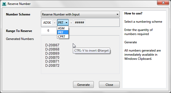

  4. Use Data Standard in Vault to reserve a range of numbers.
  5. Copy the reserved numbers and paste them into the Part Number column in the member table.
