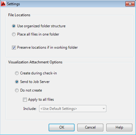

    Submit a Job During Check-in
    You can submit visualization attachments to the job processor when checking files into a vault.
    1. Start to check in a file.
    2. In the Check-in dialog, click the Settings button and select Send to Job Server in the Visualization Attachment Options section.
    3. Click OK and complete the check-in.
    The visualization attachment is sent to the job processor.
