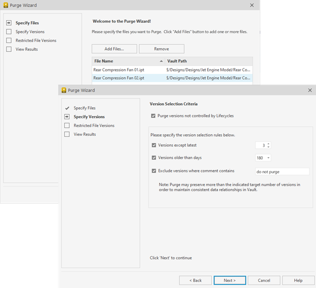

To purge files from the main Vault Client:
Select a file or files, and then select Purge from the Edit menu, or
Right-click a file, and then select Purge.
The Purge Wizard lists the file or files that were selected from the main pane. Click Add Files to include other files from the vault.
To exclude a file from being purged, select it from the list and then click Remove.
The parents and children of a selected file can be included in the purge. Right-click on a file in the list and select Add Parents or Add Children to include the related files.
Click Next.
Click the Purge versions not controlled by Lifecycles check box to purge versions not defined by revision and lifecycle rules. This action enables the Specify the version selection criteria box.
In the Specify the version selection criteria box, turn on the check box next to each of the selection rules to determine the data to be purged:
Versions except latest Specify how many file versions to leave in the vault. Versions older than days Specify how old the files to purge should be. Exclude versions where comment contains Enter a text string contained within the Comments field of the files in the vault. Any files containing this string will be excluded from the purge process. This option is only available if any of the above checkboxes are selected.
Enter an asterisk (*) in the Comments field. Any file version which has a comment will be excluded from the purge.
Note: This asterisk (*) workflow is supported only for 'Versions not controlled by Lifecycles.’
Click Next.
If there are any restrictions on the versions to be purged, the restricted versions and the reason for the restrictions are listed.
Click Finish to purge those versions that are not restricted, or click Cancel to exit the Purge Wizard.
Note: Versions that are restricted because they are linked to items in Vault Professional cannot be purged unconditionally when the version is a dependent of a parent file version. The corresponding item must be deleted from the item master before the version can be purged.The Purge Results screen summarizes the versions that were successfully removed and the versions that were not purged due to vault restrictions.

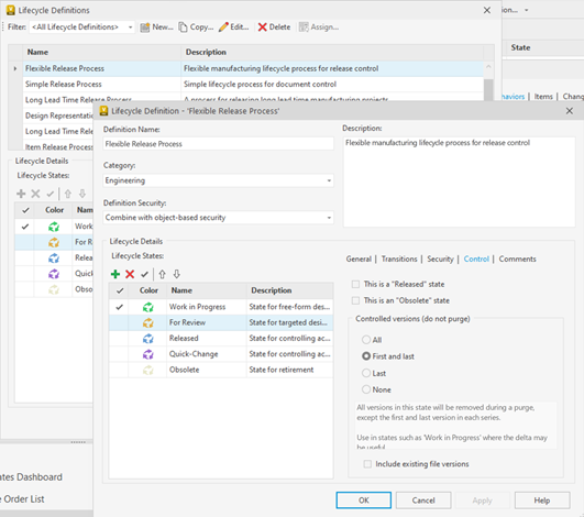

Purging in case of lifecycle states
When you set up your lifecycle states, there is a Control tab where you can set what file versions should be kept: all versions in that state, the first and last versions, the last version in that state, or none. Configure your purge preferences for files assigned to a lifecycle definition to help manage Vault file retention. Purging Vault will always purge first based on lifecycle control settings.
To configure the control preferences:
Click Tools > Administration > Vault Settings.
In the Vault Settings dialog, click the Behaviors tab > Lifecycles.
In the Lifecycle Definition dialog, select the name of the lifecycle definition, and then click Edit.
From the Lifecycle States grid, select the state you want to edit and click the Control tab.
Select one of the following options:
- All - No versions in this state are removed when a purge is performed. This option is recommended for states where not many versions are created or where each version is critical.
- First and Last - All versions in this state are removed during a purge, except each series' first and last version. Use this option for states where the changes between the first and last files are helpful.
- Last - All versions in this state are removed during a purge, except the last version in each series. This option is recommended for states where a record that the file was in the state is essential.
- None - No version in this state will be retained after the purge, except the tip version of a revision and the versions consumed by a parent file.
Note: The basic purging rules are also applied to the selected optionImportant: No record of the file in this state will exist after the purge.
Turn on the Include existing files versions check box to apply purge restrictions for lifecycle states for existing versions of files.
Note: If this box is not checked, the purge version control settings apply only to new file versions.
When you now purge your vault, the list of eligible files and items is built from the lifecycle control setting for that version.
Here is an example that highlights what files will be purged in a lifecycle scheme scenario. Considering there are no dependencies, the following are the purge settings:
- Released: Last
- For Review: First and last
- Work in Progress: None
We have different versions at different revisions and lifecycle states.
| V1 | V2 | V3 | V4 | V5 | V6 | V7 | V8 | V9 | V10 |
| Rev A | Rev A | Rev A | Rev A | Rev B | Rev B | Rev B | Rev C | Rev C | Rev C |
| Work in Progress | Work in Progress | For Review | Released | Work in Progress | Work in Progress | Released | Work in Progress | Work in Progress | Work in Progress |
Now, upon purging, all the versions except V3, V4, V7, and V10 are purged as per the criteria and the following versions remain after purging. It doesn't matter if we have selected to keep the last three or the last five under the selection criteria.
| V3 | V4 | V7 | V10 | ||||||
| Rev A | Rev A | Rev B | Rev C | ||||||
| For Review | Released | Released | Work in Progress |
