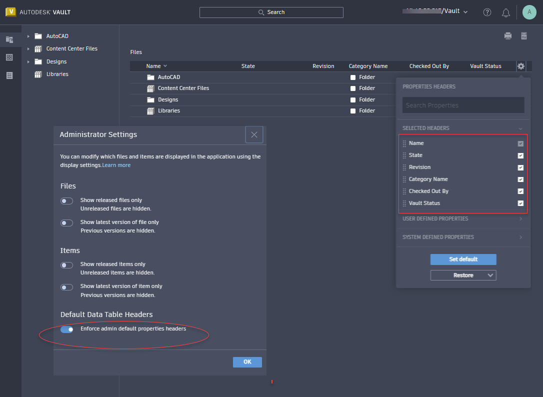

Set default columns
As an administrator, you can now configure the required columns and enforce the same for all users. When enforced, non-admin users cannot change the default columns.
For more information, see Thin Client - Work with Vault Data.

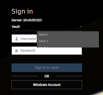

Select Vault to connect
Vault 2023-2 allows you to view all available vaults and select the vault you need to connect to at the time of signing in to the Thin Client. The vault name in the URL changes upon selecting a vault. You can also change vaults in the Thin Client interface after signing in to the Thin Client.
For more information, see Thin Client - Get Started.
