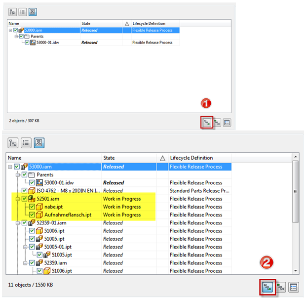

    Note: Select direct parents to include members when releasing the factory.
Release iFactory
  • Members derive from iFactory.
  • iAssembly Factory may contain normal parts/subassemblies as well.
  • Check Member option.

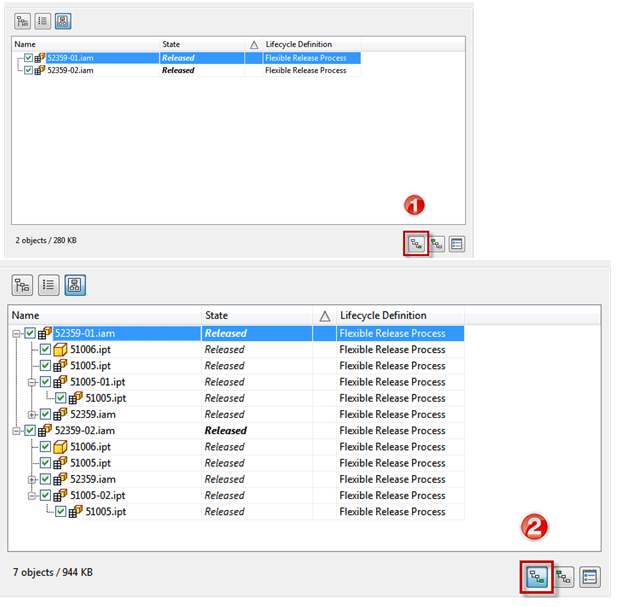

Release Members
  • Check member option.
  • Check that all members are up to date before releasing.
    1. Get all latest version of the children.
    2. Open members separately.
    3. Place in empty assembly.
  • Use quick-change if updates appear after releasing the members.
