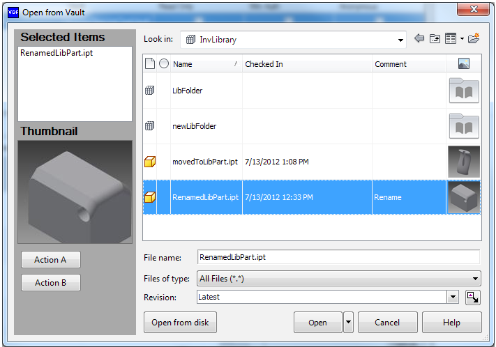

| | The following elements can have their text replaced by user-specified values: - Dialog Caption
For example, in the dialog image, the Dialog Caption is configured as "Open from Vault."
- Selection Label
For example, in the dialog image, the Selection Label is configured as "File name."
- Initial Selection
The initial value of the text box next to the Selection Label. - Selection Filter Label
For example, in the dialog image, the Selection Filter Label is configured as "Files of Type."
- Action Button Text
For example, in the dialog image, the Action Button text is configured as "Open."

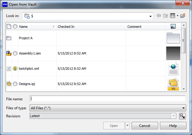

| Initial Vault Location |
| | Configure the default vault location that displays when the dialog is activated. If the default location is not specified, the dialog displays the files located at $/. |
