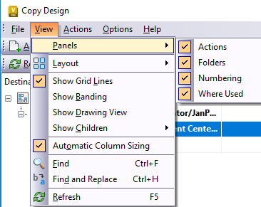

View Menu
Panels
Select which panels you want to display in the Copy Design dialog.

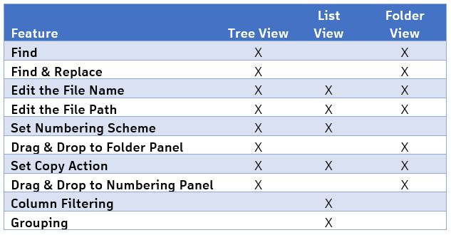

Layout
Customize how the main grid looks. You can select from three views:
  • Tree View: Displays the assembly in an organize configuration which shows the hierarchy of the assembly and associated files in the copy process. It enables you to understand the relationship of all files involved in the copy process. The following operations are available in the Tree View: Find, Find & Replace, edit the file name, edit the file path, Set Numbering Scheme, drag & drop to the Numbering panel, set Copy Action, and drag & drop to the Folder panel.
  • List View: Displays all of the files associated with the file selected in the copy process. The following operations are available in the List View: edit the file name, edit the file path, Set Naming Scheme, set Copy Action, column filtering and grouping.
  • Folder View: Displays the destination folder where the new files are placed after the copy process is complete. The following operations are available in the Folder View: Find, Find & Replace, edit the file name, edit the file path, drag & drop to the Numbering panel, set Copy Action, and drag & drop to the Folder panel.

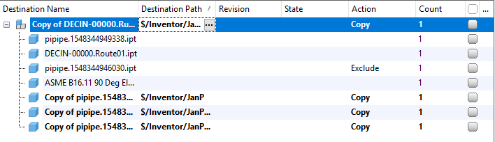

Main View Grid
The main Copy Design view shows the name of the files available for copy, destination folder, the action that will be performed on the file, the revision and state of the file, and how many instances (count) of the file occur within the current list.
Tip: By default, reference file names are set to the destination file name when an action is assigned. You can view the Numbering Panel to identify files by original name or add File Name (Historical) to the main view.
You can also manage copy actions and customize the view from the main view.

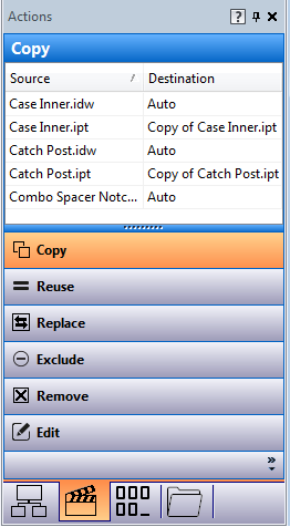

Actions
The Actions Panel lets you review which operations are assigned to be performed on files in the main view.
Once you have configured the files in the main view, you can use the Actions Panel to filter the files based on their assigned operation. Assigned operations include copied, reused, replaced, excluded, removed, or edited.
Note: You can also set action operations by dragging and dropping files from the main grid onto the desired operation button in the Actions Panel.
See Actions Panel for more information.

Hide or Show Panels
  • In the Copy Design dialog, click View > Panels.
  • Select the panels that you want to show in the Copy Design interface.
