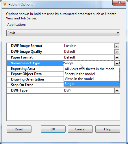

Revit Options
This table describes the publishing options available for Revit.
Option
Description
DWF Image Format
Specifies whether the file is lossless or lossy.
DWF Image Quality
Specifies whether images in DWF are exported as PNG files (default) or a compressed JPG format with quality settings (Low, Medium, High).
Paper Format
Specifies the paper format (ISOxx, ANSIxx, ARCHxx) for 2D views/sheets.
Views Select Type
Specify which view(s) you need to publish.
  • Single–publishes the last saved view/default view.
  • Sheets in the model–publishes all sheets.
  • Views in the model–publishes all views.
  • All views and sheets in the model–publishes all sheets and all views.

Publishing Options Management
Note: You must be an administrator to configure publishing options.
  1. Click Tools > Administration > Vault Settings.
  2. In the Vault Settings dialog, click the Visualization tab.
  3. Click Options.
  4. On the Publishing Options dialog, select the Application for which you want to customize the visualization settings from the Application list.
  5. Select the check box next to each publish option that you want to enable. Or if the option has predefined values, select one from the list in the Custom column.
  6. Click OK to save your changes and close the Publish Options dialog.
Note: Click Reset at any time to restore all of your changes for the current session to the default values.
