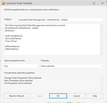

Here is the default view of the Change Order email notification template you will see under Vault Settings before selecting any properties.
Tags are placeholders in email templates that auto-populate information in the email. For instance, {EntityName}.
Below is the list of default tags:

In the Vault Client, click Tools >Administration > Vault Settings.
In the Vault Settings dialog, select the Change Orders tab.
Click Customize next to Customize the email notification for Change Orders.
Edit the subject of the email as required.

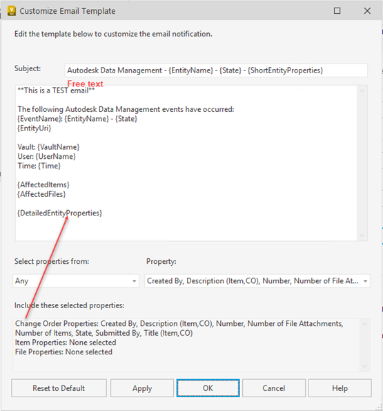

Add/edit the content in the email. You can also move the text within the email body.
Add/edit property attributes in the email body.

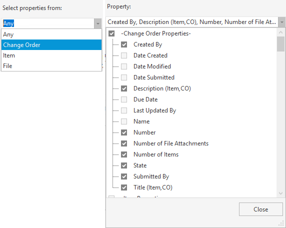

To add property attributes in the email body:
From the Select properties from drop-down list, select the workspace from where you want to add the properties.
From the Property drop-down list, select the checkbox for the properties that you want to list in the email body, and then click Close. The selected properties are listed in the Include these selected properties section.
A new property attribute {DetailedEntityProperties} is added to the email body below the {AffectedItems} and {AffectedFiles}. You can copy and paste {DetailedEntityProperties} to rearrange it to another section of the email body.
Note: Only tags part of {DetailedEntityProperties} are displayed in the email body.
Note: You can add free text to the email body but cannot add it beside any individual property that is listed under the Include these selected properties section.Click Apply to save the changes.
If desired, click Reset to Default to reset the template to the default state.
Click OK.

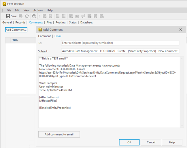

Create a new change order to find a preview of the email notification.
To preview the email notification:
- Create a new change order.
- Click Add Comments on the Comments tab.
- Click on the Email tab in the Add Comment dialog.
You can edit the email subject as well as the email body for the change order.
