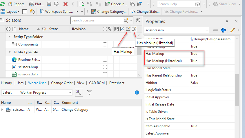

"Has Markup" and "Has Markup Historical" Properties
Two new "Has Markup" and "Has Markup Historical" system properties are added to help identify files or versions with associated markup data. With these properties, you can filter all files within a project that have markup data both historical or latest.

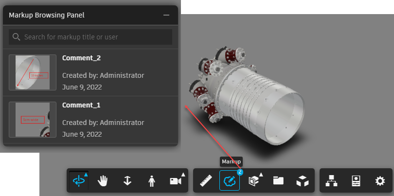

Markup Count
You can now see a number on the markup icon indicating how many markups are associated with the file. Click the markup icon to view the markup details in the Markup Browsing Panel.
For more information, see Markup.

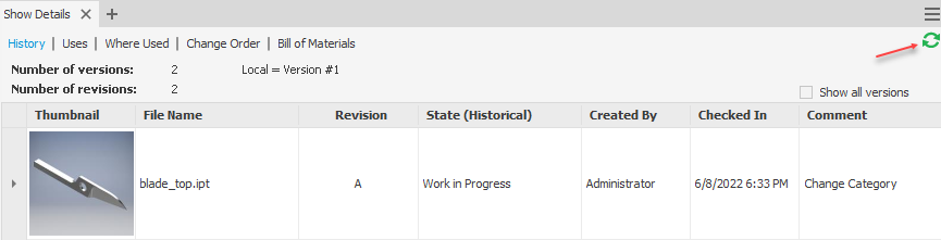

Refresh
The Refresh button is added in the Inventor/AutoCAD Show Details pane to refresh the content.

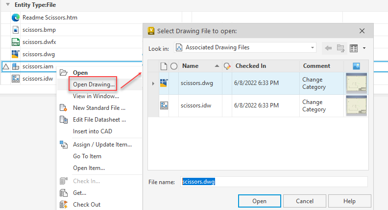

Open Drawing from Vault Client
In the file context menu, use the newly added Open Drawing command to open the associated drawing file from the Vault Client.
Note: The Open Drawing command is supported in Inventor and SolidWorks only.
For more information, see Open a File from Vault with Vault Client.

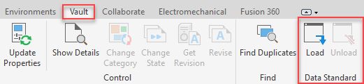

Load, Unload Data Standard
In Autodesk Inventor, use the Load, Unload button on the Vault ribbon to enable or disable the Data Standard add-in.
For more information, see Data Standard - Add-ins.

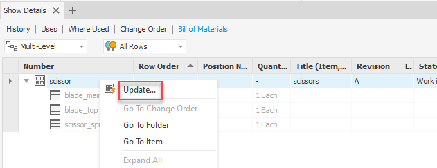

Update Item BOM
Use the Update command in the Show Details BOM tab context menu to update the Item BOM. With this enhancement, you don't need to go to the Uses tab or Vault Explorer Item to get the Assign/Update command.
For more information, see Show Details in Inventor.
