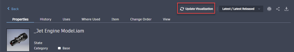

Update File Visualization
Visualization files can be updated so that the latest DWF of a CAD file is available. When a visualization file is updated, the job is sent to the job server for processing. The Update Visualization file command is only available if the job server is enabled and turned on.

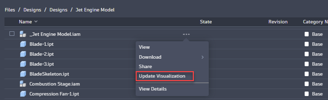

Select the Files workspace in the navigation pane.
Hover over a row and select the Ellipsis icon
of the file to update.Note: On touch screen devices, tap a row to the right of the file name to reveal the Ellipsis icon.Select Update Visualization to send the job to the job processor.
Alternatively, select the "Update Visualization" command available in the file's details page.

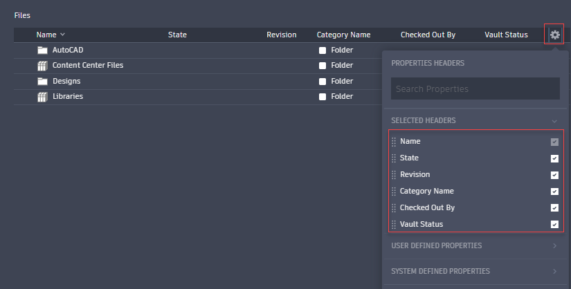

Modify Data Table Headers
You can modify or rearrange the display order of headers and also add system-generated or user-generated properties to the header.
To modify table headers:
- Select the Configure Columns icon
in the far-right of the table header. - Select the properties that you want to display.
- Click, or tap and hold on touchscreen devices, to drag a header and rearrange the display order. Press Ctrl or Shift to select multiple properties.
- To hide a header, unselect the checkbox.
You can always return to the properties originally set by the administrator.
- Click Restore default order to set the last default order set by the administrator.

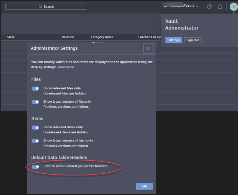

For administrators:
If you are an administrator, you can configure the required columns and enforce the same for all users. Once this is enforced, non-admin users can't change the default columns in Files, Items, Change Order, and Search workspace. Currently, admin defined headers are not enforced on the search workspace.
- Click Set default.
You can always return to the properties originally set by the previous administrator or set by the system.
- Click Restore > Default order to set the last default order set by the administrator.
- Click Restore > System default order to set the system default properties header.
