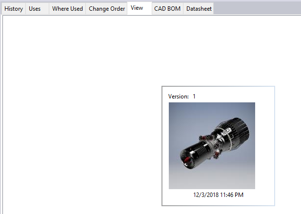

You can preview a file before you open it for editing by choosing a file and selecting the View tab in the Preview pane.
To view a file in Vault:
  • Select a file.
  • In the preview pane, click the View tab.
The preview style defaults to a carousel view of thumbnails, allowing you to cycle through historical versions of the file in Vault Basic and historical revisions of the file in Vault Professional. The file version or revision is displayed at the top of each thumbnail, and the last check-in date is displayed at the bottom.
The Viewer
The Viewer includes tools to explore, examine, and review the design. The Viewer automatically converts your design files to a representation of the designs.
  1. In the View tab, click the thumbnail to view the file.
  2. The selected file is displayed in the preview pane using Autodesk Viewer or Autodesk Design Review (depends on the option selected under Configure Vault Options for viewing the files). By default, the Autodesk Viewer is set to view the files.
  3. Click View in Window to view the file in a separate window.
