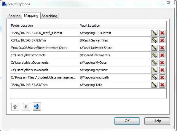

Map any local, network, or Revit server folder to any Vault folder on the Mapping tab of the Vault Options dialog.

  1. Click Options on the Vault Ribbon tab to launch the Vault Options dialog.
  2. Selecting the Mapping tab.
  3. Click Add to launch the Create Mapping wizard.

  8. On the Select the Vault folder screen of the Create Mapping wizard, enter the path or click the ellipses (...) to browse to the Vault folder to which you will map your file system or Revit Server folder.
  9. Click next to validate the mapping.

  11. Click OK on the Vault Options dialog to save your mapping changes.
    Important: If you do not click OK on the Vault Options dialog, your mapping changes are not saved.

Reorder Mappings
Mappings are listed in order of priority.
  3. Select one or more mappings and use the Move arrows to arrange the mapping in the preferred order.
