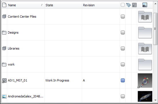

| Detail Grid View |

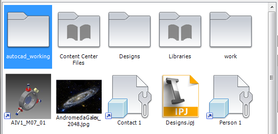

| Thumbnail View (medium-icon-view) |

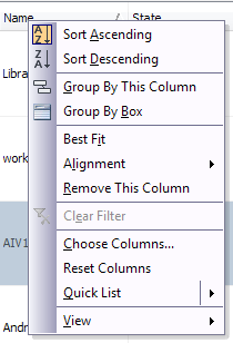

| Column Header Context Menu |
| | The context menu for each column header provides a number of options for customizing the information presented in that column. |

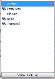

| Column Quick List |
| | The column quick list provides easy access to often-used columns, so they can be shown or hidden in the grid. |

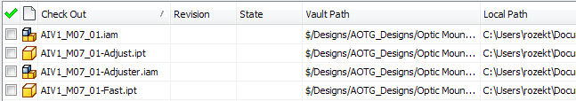

| Custom Properties/Columns |
| | New properties and their corresponding columns can be created programmatically and added to an instance of the browser control. They operate exactly like columns created by the framework itself, except the data and configuration is provided by you. In the following image, the checkbox column and the Local Path column are both custom properties. |

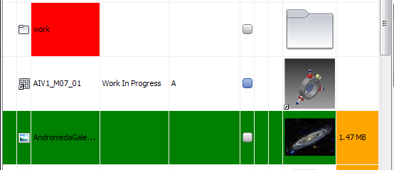

| Custom Styling |
| | The fonts, foreground, and background colors of entities in the detail grid view are fully customizable. This customization can either be done on a per-row basis, or on individual cells in a specific column. |

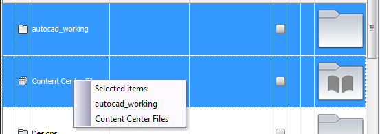

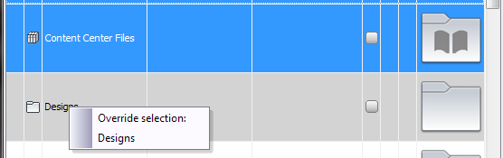

| Override Selection |
| | When right-clicking outside the collection of currently selected entities, the grid control supports a temporary override selection in all of its available views. This selection lasts as long as the context menu is up and temporarily replaces the regular selection reported by the control. This can be programmatically enabled or disabled. |

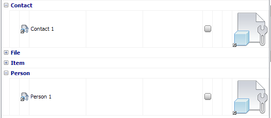

Support for Custom Entities |
| | The browser control has full support for custom entities. All of the features that operate on files and folders also work with custom entities. |
