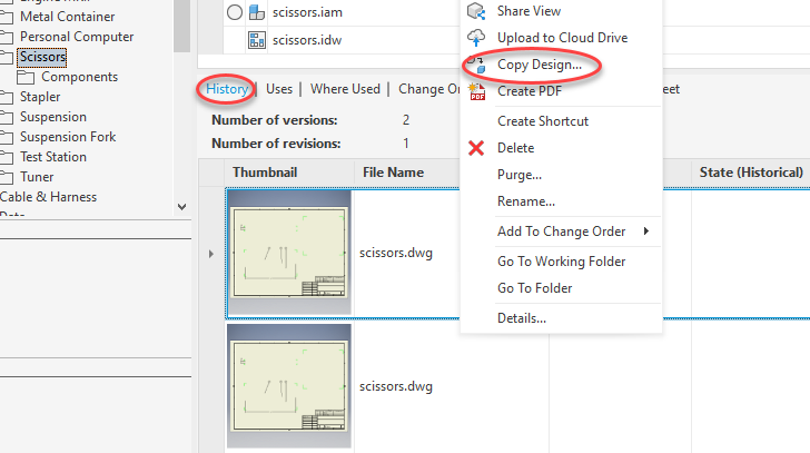

You can access Copy Design in the Vault Client, the Inventor, or AutoCAD add-ins or launch the stand-alone application.
Vault Client Perform one of the following tasks to launch Copy Design in the Vault Client.
- Select the top-level assembly drawing and right-click to select the Copy Design command.
- Right-click on a file or group of files in the main view and select Copy Design.
- Select a file or group of files in the main view and click Edit > Copy Design.

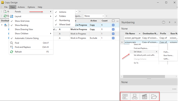

Right Panel (Navigation Panel)
The right panel has the Numbering panel shown by default. Select View > Panels to display the hidden panels.
Numbering Panel - Lists all the files selected for the copy operation. It also shows the original and new file names for each selected file. You can also edit certain fields and individual numbering schemes.
Hidden Panels:
- Folders Panel - Review the source and destination folders for the copy design operation.
- Where Used Panel - Track the copy objects' origin and destination.
- Actions Panel - Review which operations are assigned to be performed on files in the main view.
The features in these panels can also be performed in the main grid. See Copy Design Interface for more information.

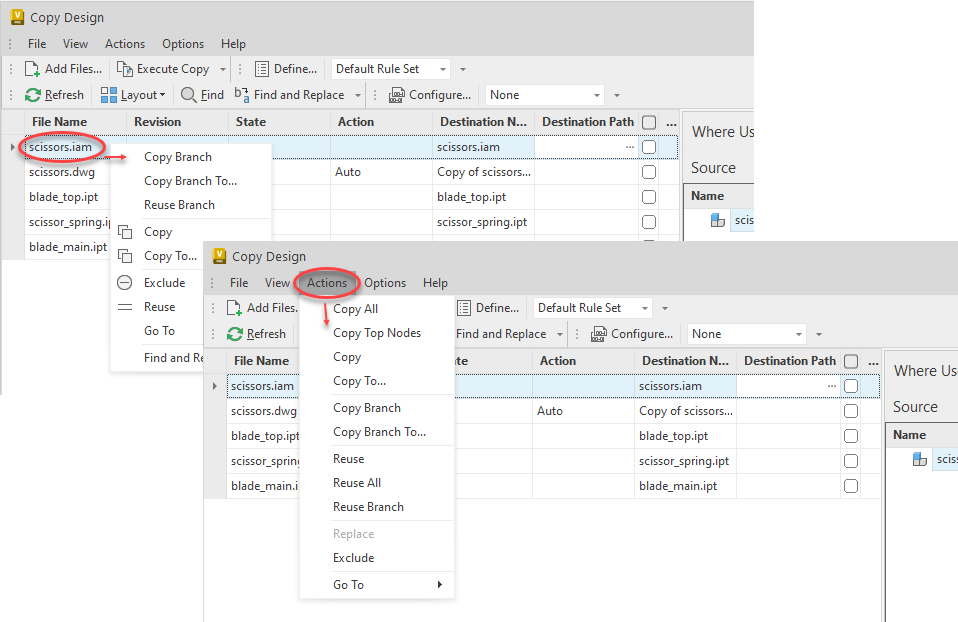

Copy Design Actions
The following list describes the actions you can perform on files in the Copy Design dialog.
| Copy All | Sets the Copy action on all files in the Copy Design dialog. |
| Copy Top Nodes | Sets the Copy action on all files at the top node in the Copy Design dialog. |
| Copy | Sets the Copy action on all selected files. Hold the Ctrl key to select multiple files at once. |
| Copy To | Sets the Copy action on all selected files, and the selected files are placed in the specified folder. Note: The original folder structure is not maintained for files with this action. |
| Copy Branch | Sets the Copy action on the selected files and the entire file structure (branch) beneath it. |
| Copy Branch To | Sets the Copy action on the selected files and the entire file structure (branch) beneath and sets the destination path to the specified folder. Note: When the copy operation completes, the copied files are placed in a specific folder maintaining the original folder structure. |
| Reuse | Sets the Reuse action on the selected files. The selected files are reused instead of creating a copy. This is a great way to minimize duplicates of a file that must be used in more than one location of a design. |
| Reuse Library Files | You can set the reuse action for the selected library file by using the action in the right-click menu. When this action is used, the selected library file initially set to copy will now be set to reuse. Note: In the new Copy Design, blank value for Action Column means the file is reused. This action is available in the right-click menu. However, it can only be accessed when a library file is selected. |
| Reuse All Library Files | This action will set all copied library files to reuse in the main grid. |
| Reuse All | All files in the Copy Design dialog are set to Reuse. |
| Reuse Branch | Sets the Reuse action to the selected file and the entire file structure beneath it. |
| Reuse Branch Library Files | This action will set all copied library files to reuse in the selected branch. Note: This action is available in the right-click menu. However, it can only be accessed when a branch library file is selected. |
| Replace | Replaces the selected file with the specified file. The name of the original file changes to the replacement file's name. |
| Exclude | Sets the Exclude action on the selected files. This action can only be used on parent documentation files. If this is set on any other file in the structure, that file is reused during the copy operation. |
| Go To | You can go to the original file in the Vault Client using the Source Folder option. After the Copy operation, you can go to the newly copied file in the Vault client using the Destination option. |

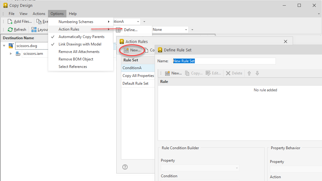

Action Rules
Action Rule sets are a collection of rules which define property behaviors on newly created files during the copy process. Rule sets can be used to reset the category of a target file, map file properties, or clear or reset file properties.
Only one rule set can be applied to the selected data set during a copy operation. For this reason, a rule set can contain several rules that determine the settings of multiple file types based on extension, properties, or use.
To create, edit, or delete Action Rule Sets:
In the toolbar, click Options > Action Rules > Define to open the Action Rules dialog.
Click New to define an Action Rule Set. See Define an Action Rule Set for more information.
- While editing a rule within a rule set, define the condition a rule must meet before the property behaviors are executed. If multiple conditions are defined for a rule, all conditions must be met before the property behaviors are executed.
- All rules in a rule set are run in priority order from top to bottom. The first rule in which the condition is met is executed on a file; the subsequent rules are not checked on the same file.

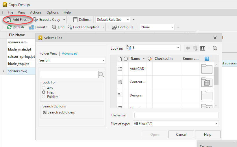

Click Add Files
from the File menu on the toolbar to add additional files for copying. Select the files that you want to copy and click Open. The files are added to the main view of the Copy Design dialog.
Tip: Click Refresh at any time to capture the latest version of the listed files and file structure.Select the file that you want to copy, right-click on the file and select the action from the context menu.
Alternatively, select the file that you want to copy, click Actions in the Toolbar, and then select the action to be performed.

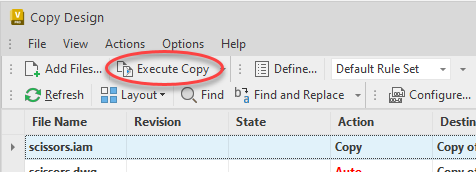

Click Execute Copy
on the toolbar to start the copy operation.
Several pre-checks are performed to ensure that:
- All files have unique names (by Folder)
- Vault unique file name rules are met
- Selected files still exist
- Files requiring edits are write-enabled
- Files requiring edits are owned by the workgroup site
All successful copy operations receive a green check in the main view. If a copy operation failed, a red cross is displayed. Hover over the red cross icon on each highlighted row to view the warning detail. You can export the restricted file list to an external file (xls, xlsx, txt, htm, html) for reference.
To perform another copy operation, modify your settings and click Execute Copy.
