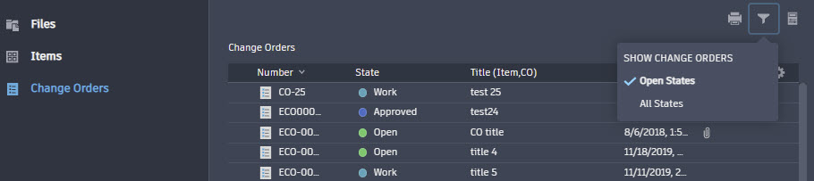

The Change Orders workspace displays change orders in your vault.
Change Orders are listed in a data table. Click the Configure Columns icon to modify the column headers in the Change Orders workspace. You can re-order or add user- and system-defined headers to the data table in the Configure Columns drop-down menu. The default order contains headers for the following data:

Customize the Change Order View
You can filter the view to only show change orders that are in Open state (Create, Open, Work, Review, Approved, Rejected) or select All States to list all change orders including Closed or Cancelled states.
To customize the change order view:
  1. Click the filter icon in the upper right corner of the Change Orders workspace.
  2. Select the "Open States" or "All States" filter. If the Open States filter is selected, all change orders in Closed or Cancelled state are hidden from the view.
    Note: The Open States include all change orders that are in Create, Open, Work, Review, Approved, and Rejected. All States include change orders in Open state as well as in Closed or Cancelled states.
By default, the Open States filter is selected.
