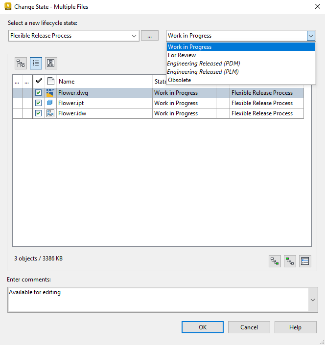

The Change State command allows users to modify the lifecycle state for files, folders, items, and custom objects. Changing the lifecycle state of a Vault object enforces certain lifecycle behaviors configured by the Vault administrator to occur. Examples of states include Work in Progress, Released, and Obsolete.
The relationship grid displays project data that was selected when the Change State command was chosen. The lifecycle definition and the lifecycle state is shown for each object listed in the grid and can be modified individually. Along the top of the dialog, the lifecycle definition filter drop-down, the lifecycle state drop-down, and the browse button are used for making bulk changes.
Choosing a lifecycle definition from the filter allows the user to make bulk state changes to all data that belongs to that lifecycle definition. Browse to another lifecycle definition to change the lifecycle definition that is assigned to the data in the grid. Only lifecycle definitions that are assigned to the category will be available in this dialog. The lifecycle state drop-down allows the user to change the state on more than one object at a time.
By default, all data in the relationship grid is checked by default and, as a rule, only the data that is checked is affected by the settings in this dialog. Any data that is unchecked ignores the changes that were set in the Change State dialog. See the Lifecycle Definition Filter and New Lifecycle State section for more information on these features.

To change the lifecycle state of a file, choose the lifecycle state drop-down and select the desired state. The per file lifecycle state drop-down lists all available states within the given lifecycle definition (for-which-a-transition-from-the-current-state-to-the-listed-state-is-an-allowed-transition).

The lifecycle definition filter drop-down contains all of the lifecycle definitions that exist for the project data listed within the relationship grid. This filter is used in conjunction with the lifecycle state drop-down. The two fields are used to update all data within a given lifecycle definition to a new lifecycle state. If the user wants to change all of the project data in a given lifecycle definition to a new lifecycle state, here's the workflow:
- In the lifecycle definition filter drop-down, choose the lifecycle definition for which you want to do a batch update.
- In the lifecycle state drop-down, select the new state for the files assigned to that lifecycle definition. This action changes only the lifecycle state of files with the lifecycle definition specified in the lifecycle definition filter drop-down.
For example, if you want to change all files in the grid that are in the Basic Release Process to the Work in Progress state, choose Basic Release Process in the Lifecycle Definition Filter drop-down. At this point, no changes have been made to states within the grid. Next, choose Work in Progress from the lifecycle state drop-down. All files in the grid that have the Basic Release Process are changed to the Work in Progress state.
