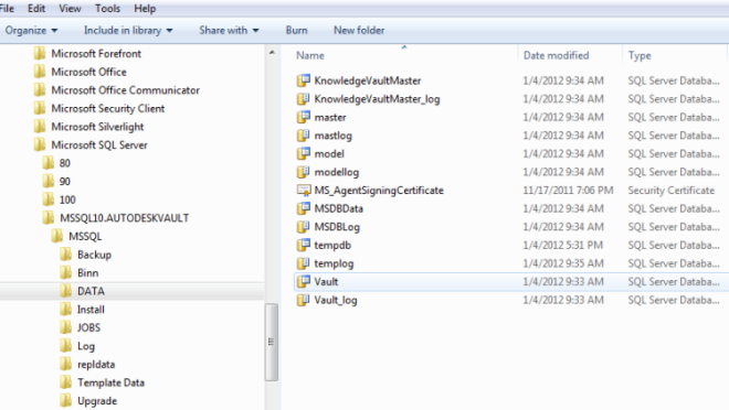

When you install the Autodesk Vault server, a single vault named Vault is created. The database files for the vault are created in the MSSQL$AUTODESKVAULT\Data folder under the Microsoft SQL Server installation folder.
Several of the databases located in the Data folder are used by Microsoft SQL Server while others are specific to the vault. Each database file (mdf) has an associated log file (LDF) that contains important transaction data and must be moved, backed up, and restored along with the database file.
- KnowledgeVaultMaster.mdf is the master vault database and it maintains the list of users, user permissions, and a list of vaults and their corresponding file store location.
- Vault.mdf is the database for the vault named Vault. Each vault also has a SQL Server log file associated with it called VaultName.ldf.
