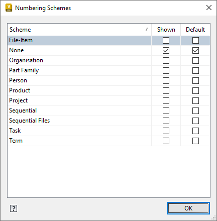

In the toolbar, click Options > Numbering Scheme > Configure
to open the Numbering Schemes dialog.
Select the Shown check box for any numbering scheme you want to display as a view button in the Numbering Schemes Panel.
Select the Default check box to set a Numbering Scheme as the default setting.
Click OK.
