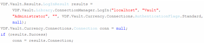

The non-GUI log-in allows client apps to provide the log-in credentials directly to the VDF without having to prompt for user input. The non-GUI log-in is done using the VDF.Vault.Library.ConnectionManager.Login() method. More information about both log-in methods and their settings/parameters can be found in the SDK documentation. Once you have a VDF connection, client applications can begin using it to interact with the Vault server via services such as the File Manager service or by providing the connection object to Library methods that require a connection.

Using VDF log-in (c#):
The other thing client applications will need to adjust is how they sign-out/dispose of the Vault connection. While the WebServiceManager was an IDisposable, the VDF Connection is not and it is recommended to release the Vault connection by passing the VDF connection you wish to log out of to the ConnectionManager's Logout() method.
