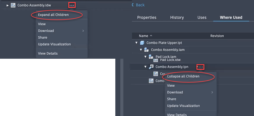

Expand all Children/Collapse all Children
To expand the collapsed rows in a tree view:
  • Hover over the parent row and click the ellipses icon (…).
  • Select "Expand all Children" to display all the rows.
Similarly, to collapse the expanded rows, hover over the parent row and select the ellipses icon (…) to select "Collapse all Children".
