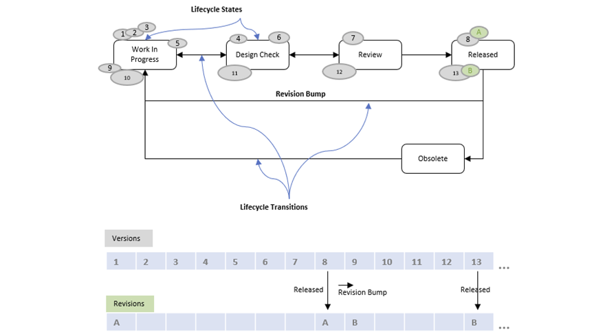

Lifecycle definition is an engine that can be configured to automatically assign security, behaviors, and properties to Vault objects based on where the object is in the life of the design process.
A lifecycle definition uses states to identify the object's status in the lifecycle. For example, let's take a simple engineering process where lifecycle states include work-in-progress, review, and released.
An object moves from one state to another based on the lifecycle definition's transition rules. These transition rules determine when the state change happens if it can occur manually or automatically (or both), based on criteria specified by the administrator. For example, a lifecycle definition can be configured to automatically revise a file when it moves from one state to another. Or, if a user changes a folder's status to obsolete, the lifecycle definition can automatically apply security settings to the folder so that only an administrator can modify the folder and its contents or reinstate it for use.
In the above diagram, the object version keeps incrementing when working in the Work in Progress state or the Released state (Revision A with Versions 1 to 8). When the object moves from Released to Work in Progress state; there is a Revision bump from A to B. So the version keeps incrementing with each checkin or state change, and the Revision increments as per the transition rule.
