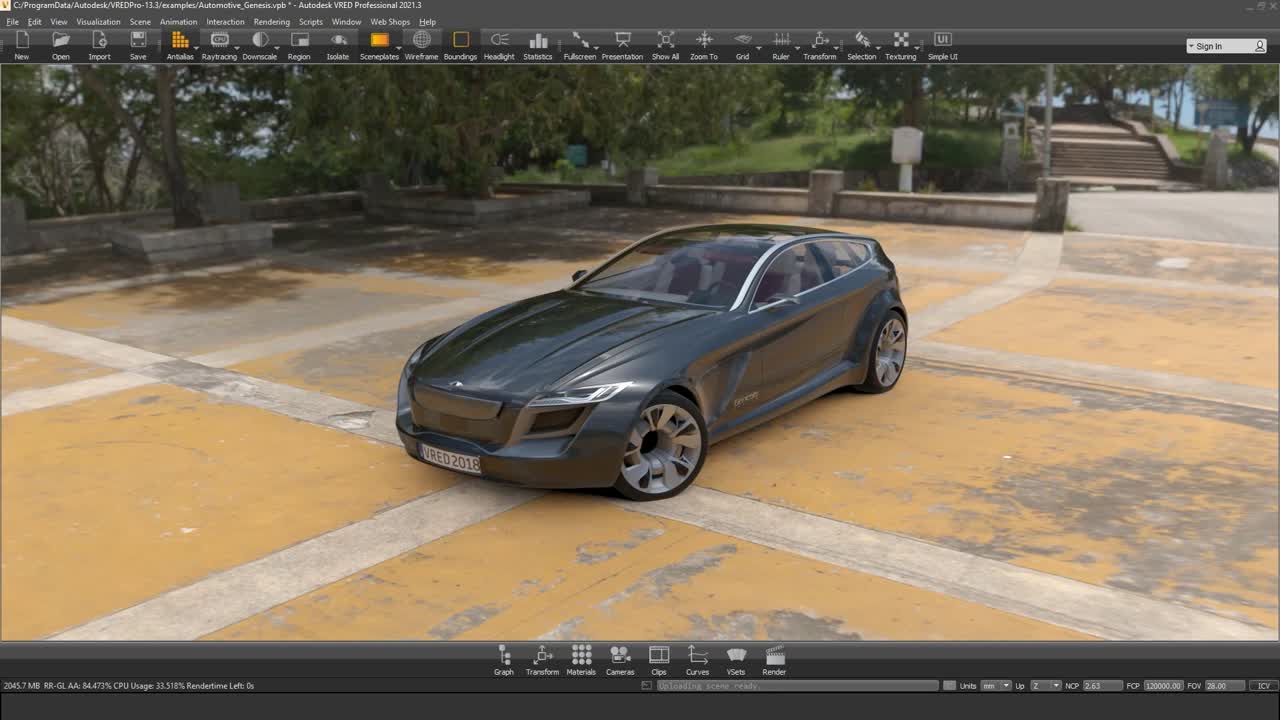

So, let’s look at some real examples. They won’t be too complex, but this is just to warm up a little bit. In a lot of scripts, you will have to access your Scenegraph in some way. The Scenegraph is the central part of 3D graphics and holds all the information about geometry, lights, transformations, and so on. It is a hierarchical structure that starts with the root node, and divides your scene into transform nodes, group nodes, or switch nodes down to the geometry itself. In a typical script, you will either add nodes or geometry to your Scenegraph, move nodes from one place to another, or you want to find a node in the Scenegraph to manipulate it.
In our first example, we start by searching nodes in our Scenegraph. We open the Script Editor that is located under Edit in the menu bar and enter our script. Here we start by searching for the root of our scene and the camera node using the vrNodeService. The camera node is called Perspective, as you can see in the Scenegraph.
Nodes are typically refered to by their name in the Scenegraph. We store the result of this operation as a variable, which now hold an object of type vrdNode. vrdNodes are defined in the API version 2. We can execute the script by hitting Run button and see the result in our print message in the terminal. This message tells us what type of objects the two variables now hold.
Next, we want to create new nodes and add it to the Scenegraph. Here we are creating a node of type Group. You can look at the documentation to find all node types you can create. To do this, we use the createNode function with the first parameter, defining the node type, the second parameter setting, its name, the third parameter, telling VRED which node should be the parent of our new node. In this case, we want our new node to be located under the root of our scene. After this, we want to call the updateSceneGraph function from the vrSceneGraph module. This command will directly show us the changes in the Scenegraph.
Let’s create some geometry and add it to our new group node. This can be done by using a set of functions that will create primitive geometry for us. Here we are using the createPlane function and the createBox function.
Notice how the editor already suggests functions we can use when we start typing. This is very helpful when writing scripts. You can just start typing and see what functions are available. Unfortunately, this feature does not tell you what parameters you have to use, so there is now way around reading the documentation. Sorry.
The first few parameters describe the size of the plane and the box, the next three parameters define the resolution, and the last three numbers defined the color, which is just 100 per cent white. I also added two functions to remove the old group node, whenever I execute the script. Otherwise, our Scenegraph would get cluttered with old group nodes.
Next, we add a name for each geometry and set their translation in the scene with the setTranslation function. This function receives an x, y, and z component that describes the position in the scene. Please note that this setTranslation function is from the API version and uses the old set of parameters, instead of the vector representation.
In the last step, we add these two geometries to our group node. Otherwise, the geometry would float somewhere in our memory, but would never be attached to our Scenegraph. When we hit Run, we now can see our new geometries in the scene.
