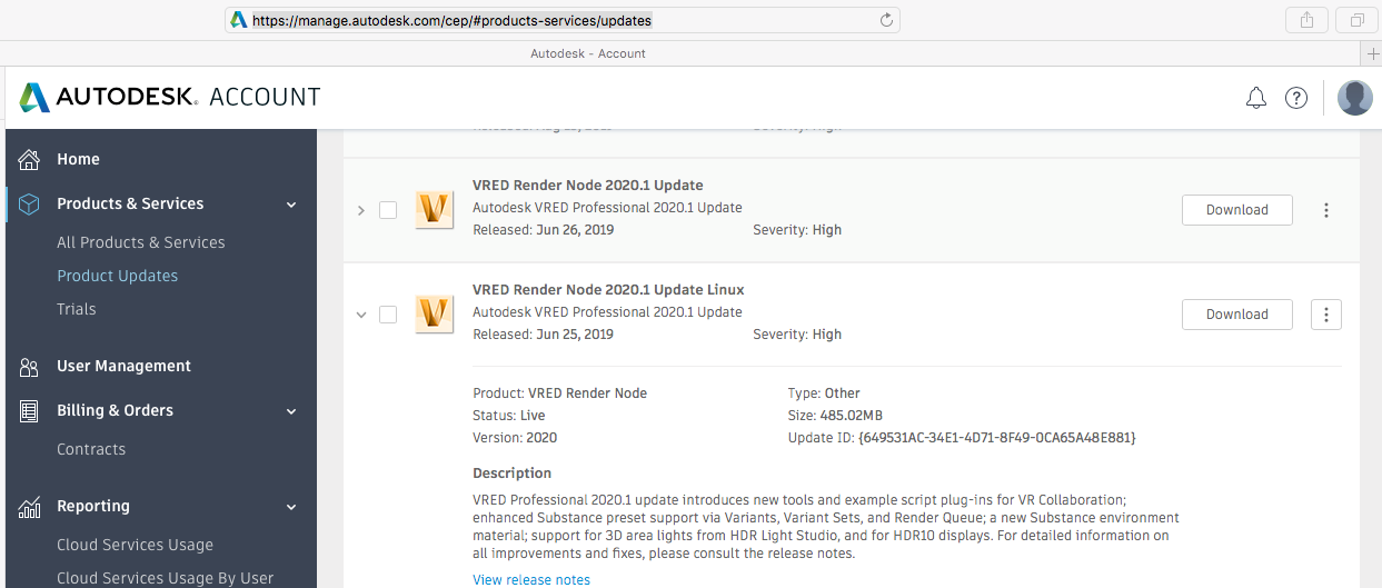

For customers who don't update to 2020.2, we have provided a zip file (VREDCluster-2020.x-LicensePatch.zip), containing a patch for VREDCluster 2020 and 2020.1 on Linux. It switches the license system from CLIC V2 to the CLM Hub to fix several issues, like write access to /var/opt/Autodesk and extra services required by CLIC v2.
The VREDCluster for Linux, also called VRED Render Node for Linux, is available only from the Accounts portal at (https://manage.autodesk.com).
If you go to (https://manage.autodesk.com), in the Products & Services > Product Updates, look for VRED Render Node 2020.1.1 License Bug Fix (VREDCluster-2020.x-LicensePatch.zip).
This zip file contains two shell script files, VREDCluster-2020-12.0-LicensePatch.sh and VREDCluster-2020.1-12.1-LicensePatch.sh.
