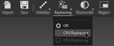

Raytracing
Generates physically correct illustrations. This means that all light sources are sending rays to any point within its area of influence and the image generator considers reflections and refraction of every ray on its calculation.
It can be toggled on or off. When off, OpenGL is used. When toggled on, choose from CPU Raytracing or GPU Raytracing.
CPU
Fewer rays are sent from the light sources on camera movement to enable smooth navigation within the Render Window. Enabling Stillframe Antialiasing affects not only the smoothing of the illustration's edges, it increases the number of rays and reflections considered during image calculation. The more allotted to time calculation, the less noise within the image.

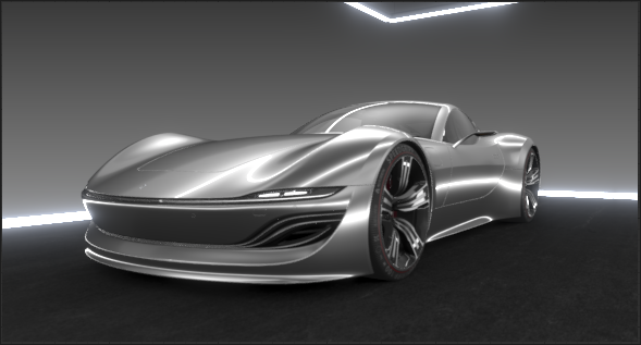

Realistic Rendering
Provides a colored and textured illustration within OpenGL or Raytracing. It enables everything required to generate photorealistic output. In raytracing mode, a selection of different render passes are provided for interactive display. To view composed rendering, choose Beauty Rendering.

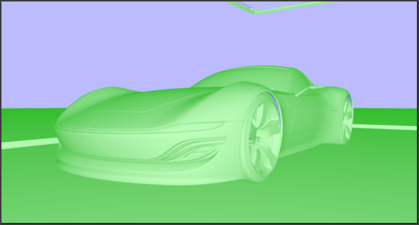

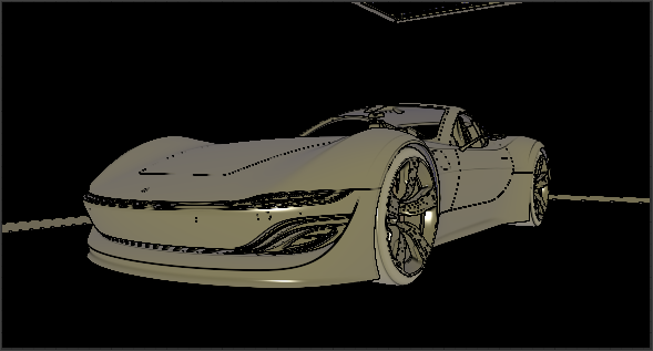

Vertex/Face Normal Rendering
Gives visual feedback about the orientation of vertex and face normals, helping you see if a surface is oriented incorrectly. It makes it easier to align inconsistent normal orientations. See Working with Normals for how to use this.
Normals
Four colors are used to indicate different normal orientation:
  • Green - Face and vertex normals are consistent and point towards the camera.
  • Blue - Face and vertex normals are consistent and point away from the camera.
  • Gold - Face and vertex normals are inconsistent. Face normals point away from the camera; vertex normals point towards the camera.
  • Magenta - Face and vertex normals are inconsistent. Face normals point towards the camera; vertex normals point away from the camera.
  • Red - As of 2023.2, face and vertex normals are NaN or have a zero length, which creates NaNs when normalized.
  • Pink - As of 2023.2, face and vertex normals have an absolute angle between the face and vertex normal above a threshold, such as 85°.
The best way to turn face or vertex normal orientation when the whole shape is affected is to use the Geometry Editor (Scene > Geometry Editor). Inconsistent normals within one shape require pressing the Alt key in combination with the right-mouse button on the affected area. This aligns the orientation of face/vertex normals with the orientation of the faces and vertices around it. If all normals are consistent, upon operation, it enables you to turn them completely.

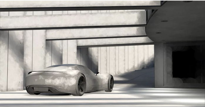

Ambient Occlusion Rendering
Creates a grayscale rendering, in which the pre-calculated ambient occlusion data is shown exclusively. This is useful when evaluating precomputed shadows. It displays any subtle variations in lighting and helps you see surface details that would be difficult to discern, so it's great for finding flaws in a surface. If the lighting in our scene is too bright, it can be used to soften it. Toggle this on to see the precalculated ambient occlusion of the scene.
Ambient Occlusion example

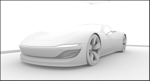

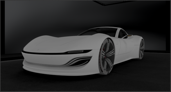

Analytic Rendering
Uses a basic shading quality, without distracting reflections. It only uses standard light sources and ignores IBL (image-based lighting).
Analytic Rendering example

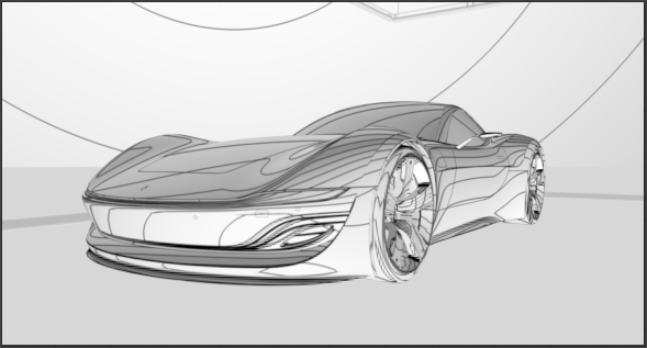

Non Photorealistic Rendering
Non photorealistic rendering is an OpenGL render mode, for rendering schematic images. Use NPR shading for outline rendering.
Non Photorealistic Rendering example

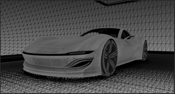

Wireframe Rendering
Shows the polygonal mesh of the selected objects highlighted in orange color. The mesh is shown in addition to the shaded illustration. Other objects can hide it until Edit > Preferences > General Settings > Selection > Wireframe > Always in Front is disabled.
This changes how the scene is rendered in the Viewport. When enabled, everything is rendered in wireframe, reducing calculation time and resource needs. The wireframe color can be set in Edit > Preferences > Rendering > Render Window > Wireframe.
wireframe rendering
When disabled, everything is rendered as expected.
wireframe rendering disabled

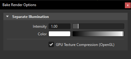

    Separate Illumination Options
Bake Render Options Dialog
  • Intensity - Controls for changing the intensity of all separate lightmaps. Use it to turn lights on and off or dim and brighten them. You can use scripts to create Variant Sets.
  • Color - Controls for changing the color of all separate lightmaps. Use it to multiply the light with a color and change it. You can use scripts to create Variant Sets.
  • GPU Texture Compression (OpenGL) - Use for separate illumination lightmaps for OpenGL rendering.
