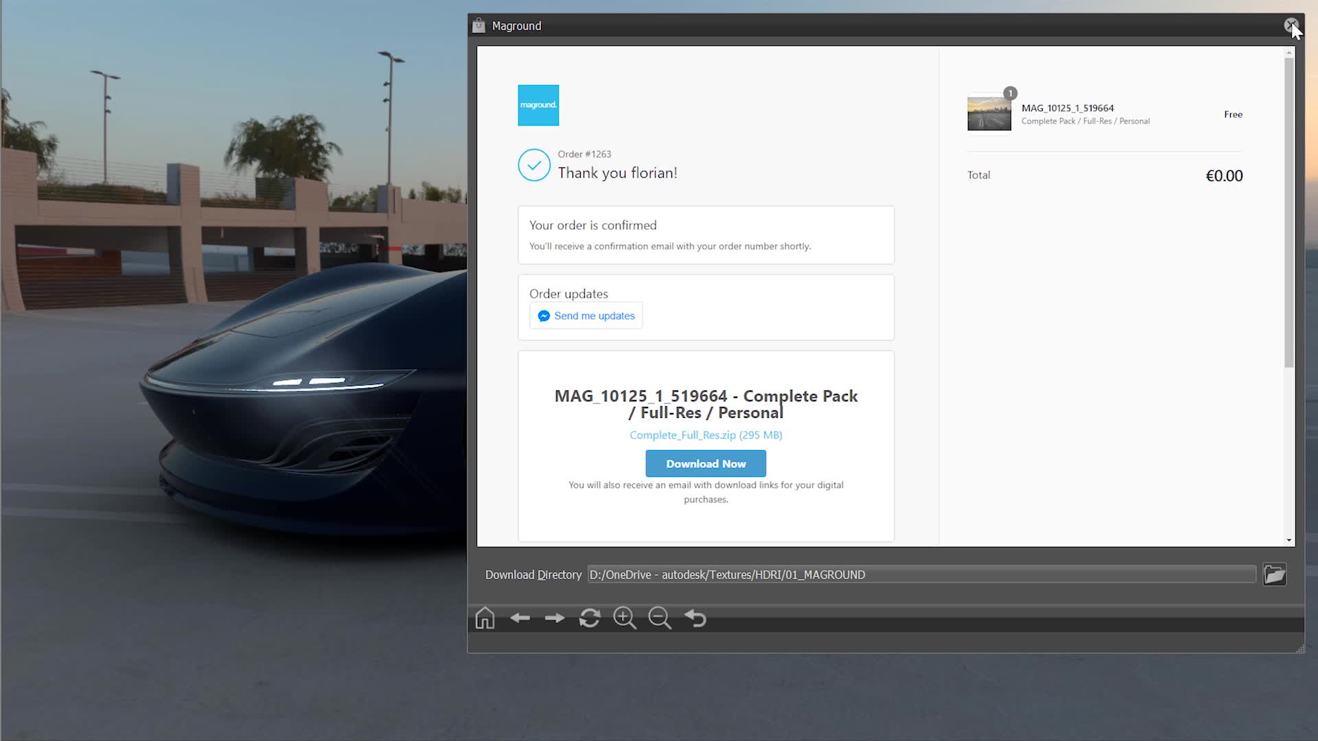

Select Web Shops > Maground to populate the Web Shop with high-resolution and free-to-use 360 degree HDR dome environments and backplates from Maground.

Maground Video Captions: In VRED 2020.1, we have now implemented the Maground Web Shop directly in the VRED UI. Under Web Shops > Maground, you can now directly connect to Maground. Within the VRED browser, you can purchase the files and download them to a specific folder, which can be customized within the preferences, as well. After the download, the asset is automatically created within the Material Editor and can immediately be used in the scene. In case you are downloading an environment map and additional backplates, VRED is automatically creating an environment node for the HDRI and backplates for the image backgrounds, which can be accessed under Scene > Sceneplate Editor. This simplifies and speeds up the workflow massively for artists who are working with Maground assets.

Autodesk and Maground joined forces to deliver 3 high-resolution and free-to-use 360 degree HDR dome environments and backplates. Simply drag an environment or backplate from the Asset Manager into the existing scene. To download more high-resolution 360 degree environments and backplates, visit maground.com and www.cgiplaygrounds.com.
