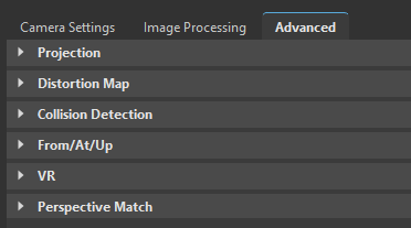

Scene > Camera Editor > Advanced
Advanced camera properties, such as projection, distortion map, and collision detection are found in this tab.
Advanced tab of the Camera Editor

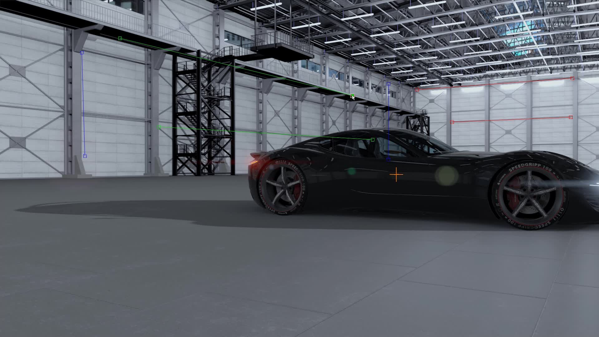

Camera Match Video Captions: In VRED 2020, we are now able to match the camera against a background image, so that the perspective in the backplate matches the camera in the 3D scene. Now, you don't have to guess the right perspective anymore or use external tools for that. The tool can be found in the Camera Editor in the Advanced tab. Just enable Perspective Match and align the vanishing lines accordingly, like shown in this example, using X, Y, and Z options. The Magnifier will help you find the right position. Now, you can adjust the object's position to the background without losing the right camera angle. In Perspective Match mode, you can do a pan, zoom, and constraint horizontal mouse navigation around the camera pivot. The vertical navigation is automatically disabled. Thanks for watching the video!
See more
Use Perspective Match to quickly position your object in front of the backplate image. Match the active camera's focal length and rotation parameters to a backplate, using the vanishing lines, to integrate your model into the scene.
learnMore icon For information on using Perspective Match, see Working with Perspective Match.

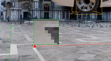

  • Magnify Factor - Sets the magnification factor of the magnifier. The magnifier appears when a vanishing line manipulator handle is selected to help with positioning.
    Magnify Factor at **2**
    Magnify Factor at **16**
    See Position Vanishing Lines Using the Magnifier for instructions on using Magnify Factor.

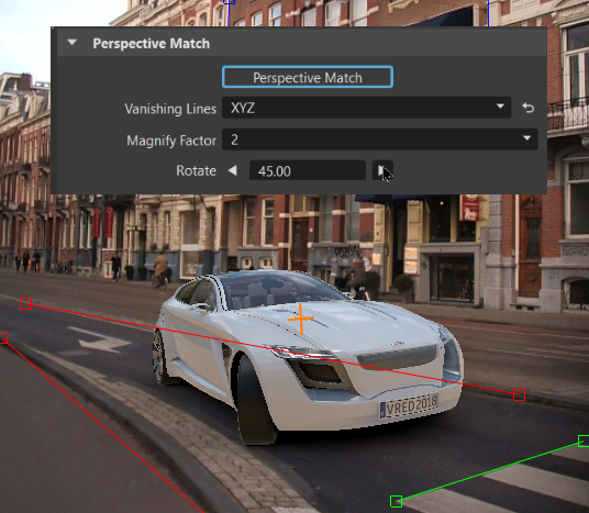

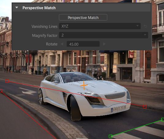

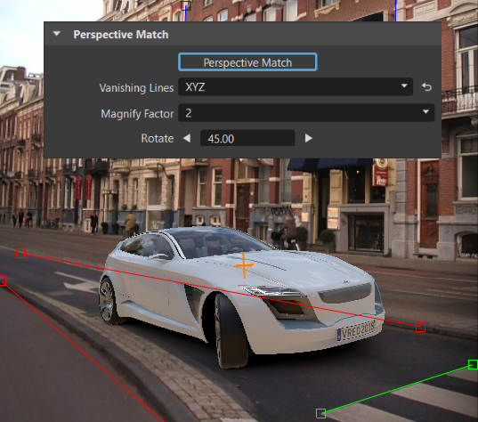

  • Rotate - Rotates around the camera pivot by the number of degrees set, changing the object's orientation against the background. Use the arrow buttons to rotate the camera about the camera pivot clockwise or counter-clockwise.
    Original
    Original pose
    Rotate clockwise
    Rotate clockwise
    Rotate counter-clockwise
