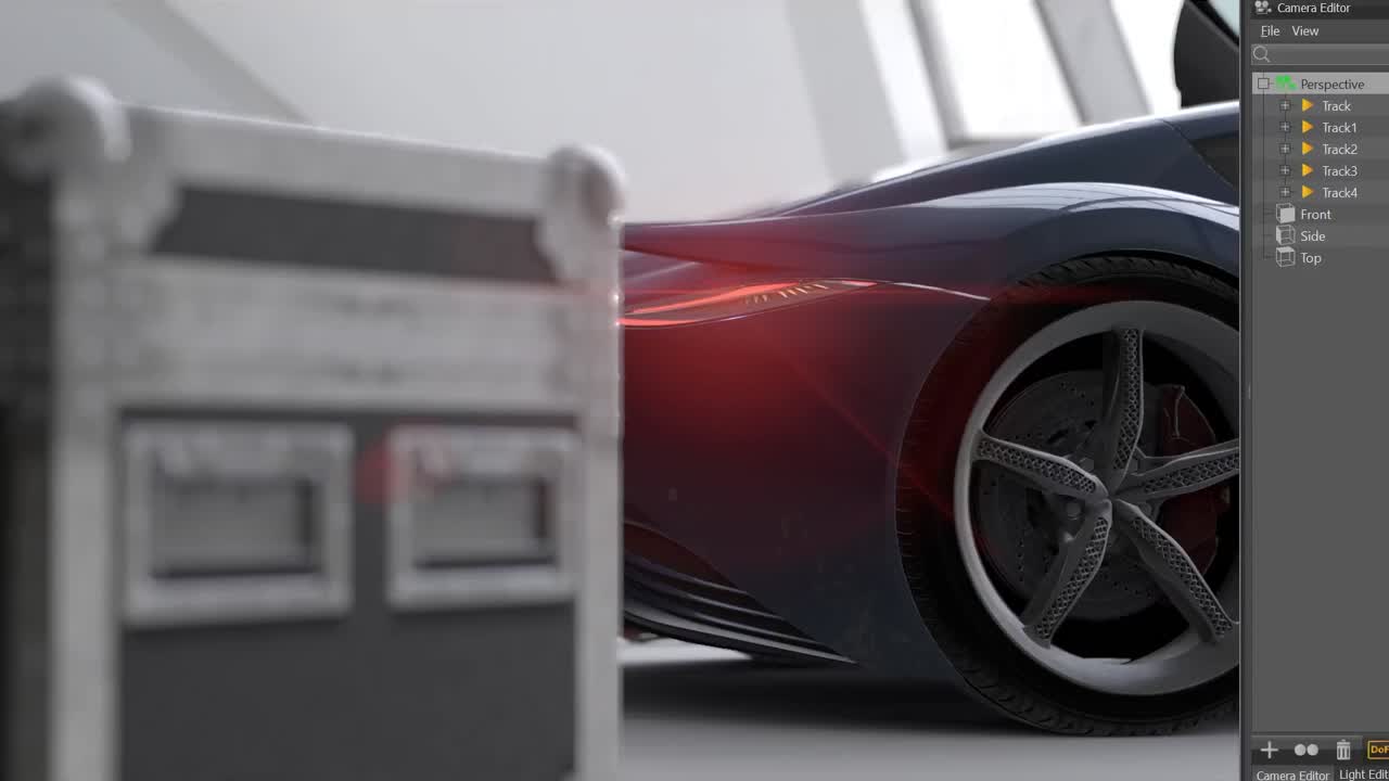

Video Player is loading.
Current Time 0:00
Duration 0:48
Loaded: 0%
0:00
Progress: 0%
1x
Video captions: In VRED 2021.3, we added interactive depth-of-field options, which works in OpenGL and raytracing. Just open up the Camera Editor and enable the Depth of Field. It can be set to different quality levels. Here you can set an optional Autofocus in the center of the image, which gives you a more cinematic look to your real-time scenes and presentations. Thanks for watching the video.
See more
Select from quality settings of Ultra Low, Low, Medium, High, and Ultra High. The computed image will be as good and realistic as technically possible, which is ideal for presenting to decision makers. The higher the setting, the higher the quality of the result, but the slower the performance. Internally, this controls the number of rays and interpolation steps used. The ray step size remains the same.
